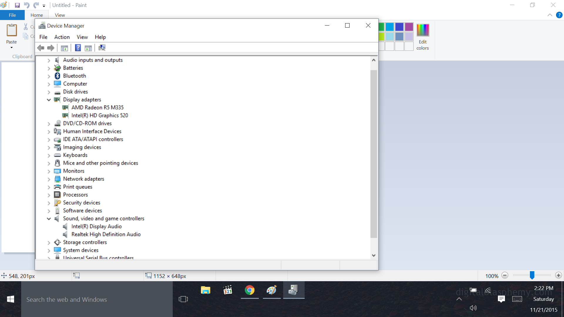

    1. What does "on board audio" mean, you mean what comes on the pc? I tried to update the driver, photo attached. I am using an older iPod (4th gen 6.1), I have a new one that does not change the quality (6th gen 9.1). It sounds more marginal than significant and most of the notice is in the bass.

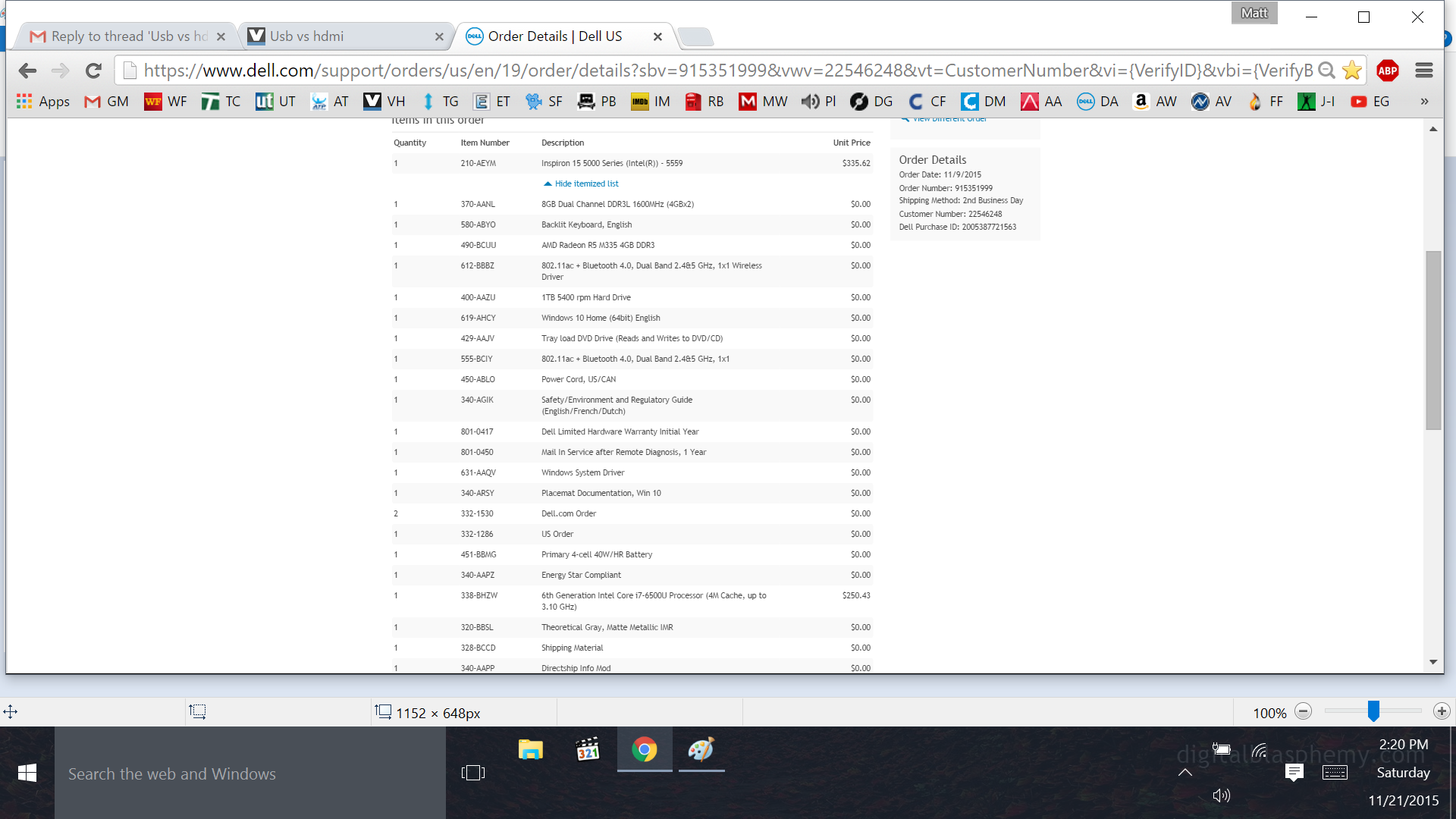

    2. Dell told me I needed the Amd Radeon to have multiple displays. It seems that both the video cards are there, and when I go to adjust the settings for m/d's it goes into Intel settings, rather than AMD. I am wondering if I even needed it, or what it's function is (the AMD)?
    I usually do prnt scrn and paste it into Paint. Upload file, so I lowered the zoom to fit all the specs. Let me know if you need more specs or if there is a more efficient way to post a scrn shot.

    The USB output of the iPod is passing untouched data. The data is simply read from memory and passed to the playback device.
    The computer output is being processed. Yes, it's still digital, but it's being read from memory and then processed by the audio chipset (in the case the video card audio chipset) to output over HDMI. You may be able to tweak the output using the audio configuration. There are usually numerous options for digital outputs.

    You are using HDMI which means the video card is processing the audio. If you want to use the Realtek you will need to use the analog audio jacks. They do sell external USB sound cards with digital outputs, but not sure if it would be worth the upgrade if you have digital HDMI audio and you already have an iPod.

    Make sure your HDMI audio device properties aren't doing something to the audio. From Control Panel select Sound, then the Playback tab. Look for the HDMI audio device then select Properties. Look through the tabs for any settings that change the sound.

    Nice advice. I did find that tab, although level was set to max. I did manage to edit pre-amp in Itunes which made a considerable difference. I think I remember trying Airplay with Itunes and not being able to adjust anything. Thanks for the help.
