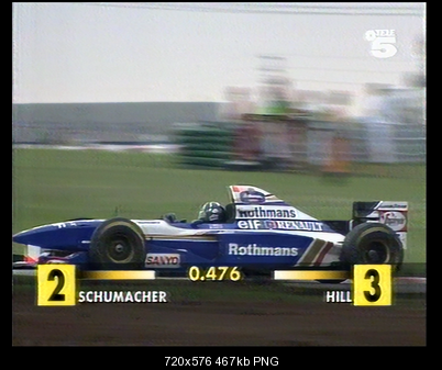

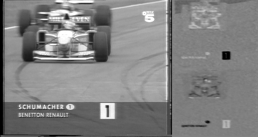

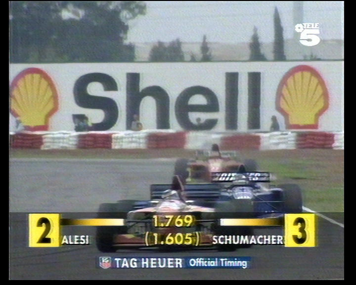

    Sadly, I'm seeing residual timebase errors in that racing sample. Specifically, lines in the logo wiggle horizontally. Does Matrox claim that the MXO2 Mini contains TBC functionality in its advertising? A quick search only found some forum posts.

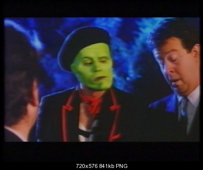

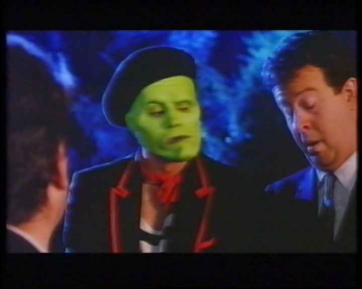

  4. Some horizontal jitter is expected even after a line TBC. The TBC can't tell why a line is shorter or longer than normal. All it can do it stretch or compress it to the right length. For example a line may be short because the video head was spinning at the right frame rate for half the line then too fast for the second half. If the line is then stretched evenly the left half will be too long and the right side will still be too short and only line up at the far right.
    I noticed in The Mask capture there is ghosting a few pixels to the right in image. I came up with a function to reduce that:
    function DeGhost(clip source, int shift, float strength)
       ygain = int(strength*256.0) - 256
       shifted = source.Crop(0,0, -shift, -0).AddBorders(shift, 0, 0, 0)
       shifted = shifted.ColorYUV(gain_y=ygain, cont_u=ygain, cont_v=ygain)
       Overlay(source, shifted, mode="Subtract")
       ColorYUV(gain_y=256+ygain, cont_u=256+ygain, cont_v=256+ygain)
    ffVideoSource("capture-3.mov")
    ConvertToYV12()
    Crop(8,60,-8,-72)
    DeGhost(last, 6, 0.15)  # reduce ghosting
    vInverse()  # clean up a little residual comb artifacts
    Spline36Resize(width/2, height)  # reduce dot crawl artifacts
    TemporalDegrain(SAD1=100, SAD2=75, sigma=4)  # reduce noise
    MergeChroma(Santiag(), aWarpSharp(depth=20))  # antialias luma, sharpen chroma
    TurnRight().nnedi3(dh=true).TurnLeft()  # restore width
    Sharpen(0.2, 0.0)  # a little horizontal sharpen
    Sample attached.

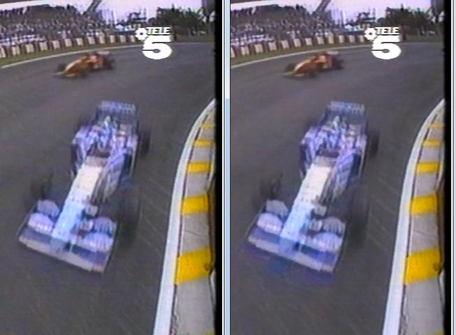

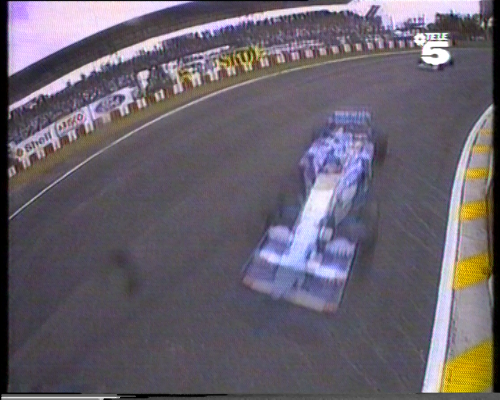

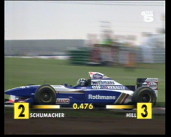

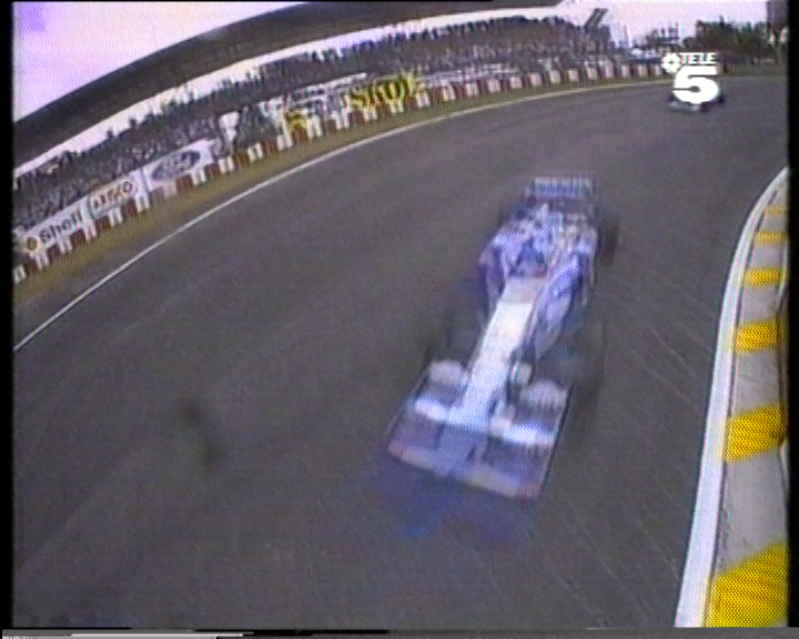

    I've contacted Matrox to send me a custom build of MXO2 driver with AVFoundation support (they send it upon request but it is not officialy published). I think it would then be possible to capture using ffmpeg which has the only Huffyuv implementatoion available for OS X that I am aware of.

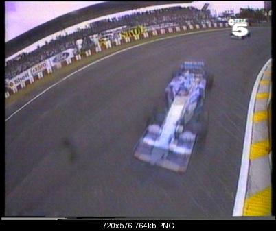

    The codec I've choosen so far for capturing and archiving is Apple ProRes 422. Although it's not mathematically lossless, it's widely used for that purpouse on Mac's workflows. And it's the only one (apart from the uncompressed master) that doesn't seem to have the blue tinge problem you pointed out on that frame:

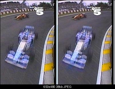

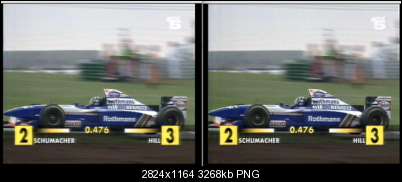

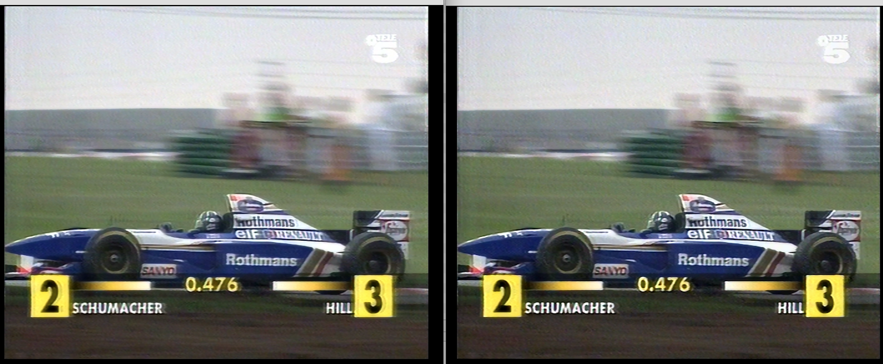

    Uncompressed (left) / Matrox MPEG-2 I-frame (right)
    Uncompressed
Name:	Clip sin tÃ*tulo 03.mov.00_00_12_00.Imagen fija002.png

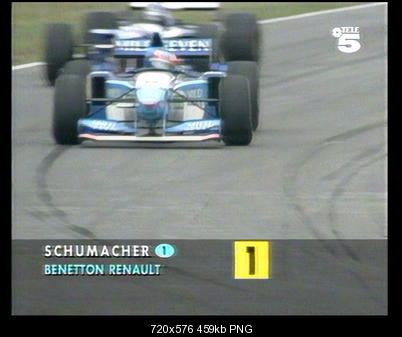

    UtVideo Pro YUV422 10bit
Name:	Clip sin tÃ*tulo 02.mov.00_00_00_00.Imagen fija002.png
    Apple ProRes 422
Name:	Clip sin tÃ*tulo 04.mov.00_00_05_03.Imagen fija002.png

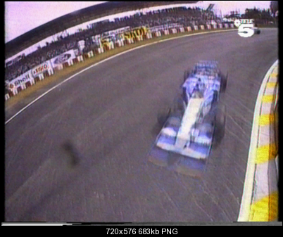

    I also tested Premiere's default capture codec and settings, but it looks like it uses Apple Video (fourcc RPZA) which is a lossy codec and the resulting video seems a little burned... or not? I'm not sure whether this one looks better or have more realistic color.
Name:	Clip sin tÃ*tulo 05.mov.00_00_10_13.Imagen fija001.png

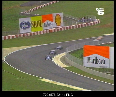

    It's a little awkward because of the reduce sized frames:
    # Absolute value of chroma after UtoY() or VtoY()
    function cABS(clip c)
        Overlay(c.ColorYUV(off_y=-128), c.Invert().ColorYUV(off_y=-127), mode="add")
    # Saturation, 0-220, same size as luma
    function cSat(clip c)
        Overlay(c.UtoY().cABS(), c.VtoY().cABS(), mode="add").LanczosResize(c.width, c.height)

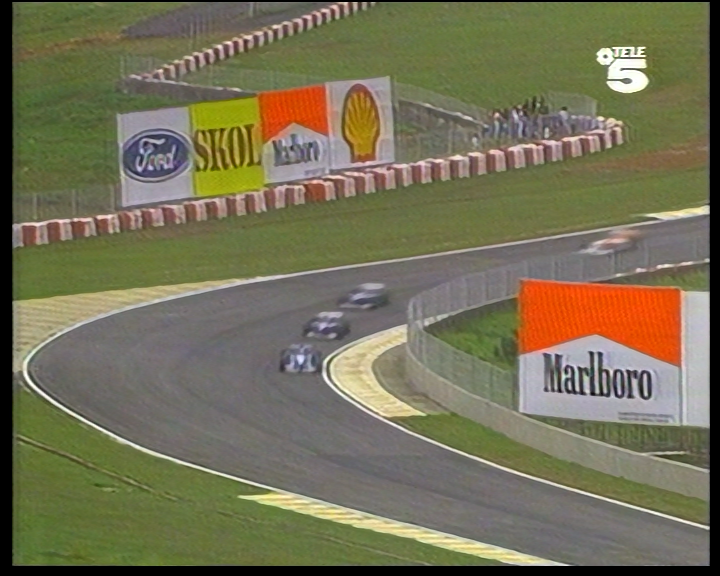

    ffVideoSource("D:\Downloads\Brasil_1.mov")
    AssumeTFF()
    ConvertToYV12(interlaced=true)
    lowres = Spline36resize(304,576).QTGMC().Spline36Resize(360,576)
    Spline36resize(360,576).QTGMC(Preset="Slow", EdiThreads=4)
    Overlay(last, lowres, mask=last.cSat().ColorYUV(off_y=-32).ColorYUV(gain_y=500))
    Dehalo_alpha(rx=2, ry=3, lowsens=20, highsens=80)
    Sharpen(0.3, 0.2)
    MergeChroma(last, aWarpSharp(depth=20))
    TurnLeft().nnedi3(dh=true).TurnRight()
    Sharpen(0.2)
    ChromaShift(l=-2, c=-2)
    Crop(12,2,-10,-10) .AddBorders(12,2,10,10)
    Here I make a lower resolution version of the video with the dot crawl artifacts are completely blurred away, then make a mask of the color saturation of the video. In the mask dark areas represent low saturation, bright area's high saturation. Then the two videos are overlaid using the mask. Highly saturated areas get the lower resolution image, low saturation areas get the higher resolution image. You can play with the intermediate size of the lower resolution image. I used 304 here because that is where the artifacts completely disappeared. At 320 they were still slightly visible. The smaller you make it the less detail there will be in the saturated areas. You can also play with the contrast adjustments of the mask to fine tune it.
    Originally Posted by Slennox View Post
    Originally Posted by jagabo
    Oh, your "after" video is encoded with the wrong aspect ratio. The SAR should be 12:11, not 1:1.
    Hmm, really? It plays well on VLC. I encoded it using yuv4mpegpipe between wine's ffmpeg frameserver and OS X's native x264:
    wine ~/.wine/drive_c/Program\ Files/ffmpeg/bin/ffmpeg.exe -i restoration.avs -f yuv4mpegpipe - | x264 --stdin y4m --preset slow --subme=10 --crf 16 -o Brasil_6.m4v -
    Am I missing any config switches for x264?
    An ITU capture of 4:3 analog PAL video has a sar of 12:11. You can add that to the x264 options as "--sar 12:11". Look at the front wheel of the car in frame 150 of the encoded video where it's almost perfectly perpendicular to the camera. In your square pixel version it is slightly taller than it is wide. After correcting for SAR it is round.
  12. Regarding the other dot crawl filters, some work with NTSC video where the dot pattern repeats every two frames, but not well with PAL which has a four frame pattern. Some are too destructive when turned up enough to eliminate the dot crawl. The ones that work work best on still parts of the picture, not on moving parts. That's a problem with VHS where most parts of the picture have horizontal time base jitter. Since it's pretty easy to (nearly) eliminate VHS dot crawl by downsizing then upsizing that's usually the way to go.

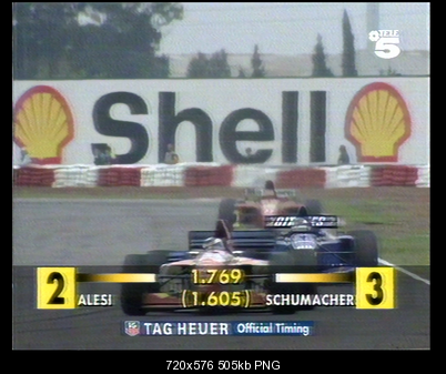

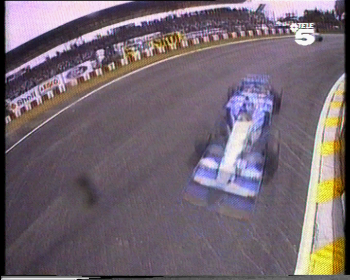

  13. The mask works pretty well and does its job. The Marlboro sign looks squeaky clean after applying it:
    Before:
    After:
    It's awesome what Avisynth can do in the hands of an skilled editor! Jagabo, thank you for all your help and thorough explanations on every step. Now I have all the workflow in place to batch encode my tapes

  18. I'm having some problems with chroma shifting in another cap. I think it is in poorer condition than the first footage we have discussed during this thread (30 sec sample)...
    Applying the restoration script you can see a white line artifact at the bottom of the "1" sign
    If I don't adjust any chroma shifting I get a better result, however some white dots can still be seen where they should be blue in the "BENNETON RENAULT" banner.
    Is possible to correct them through ChromaShift? Or it would be better to not apply the filter in this cap?

  19. Just change to ChromaShift(c=-2). That will shift chroma left by two pixels, but not up or down (l=-2 shifted it up by two lines). You'll still have a little bit of white in the blue text. The inherently low chroma resolution, along with the sharpening with aWarpSharp is responsible for some of the white. You can play with less or more sharpening.
    Here you can see the Y (left), U (top right) and V (bottom right) channels (as greyscale) of the YV12 image after only QTGMC() (contrast of the chroma channels was enhanced 2x for visibility here):
    The blue text isn't readable in the chroma channels so the colors won't line up well with the luma. So you won't get perfect blue letters on a grey background.

  20. Thanks, it seems it's the best you can do with this particular source. You've seen that huge static band on the right part of the video, I had to crop a lot of pixels. Just curiosity, do you know if it is related to the tape condition (20 years old) or the poorer signal that was recorded that time?

    Maybe we can do better. You have ghosting it seems. I have a formula with some of my captures, let's see if it works for you. (Need to try it first. Have to take off this moment, but will try it shortly with some of my methods and report back.)
    As for the static band, it may even be the way your VCR plays that tape. Yes, the more aged and warped your tape is, the more likely it will be worse. Other VCRs may play it with less of that problem there, but it may shift elsewhere. There are threads on head-switching noise you can search, but they mostly discuss such a problem at the bottom of the screen, and I personally didn't find them much help anyway.
    I'd just crop it off (and resize if need be). It's not that bad, and a part of VHS capture IMO.
    I hate VHS. I always did.
  22. Originally Posted by PuzZLeR View Post
    Yes, indeed it is. You can see the shadows near the big yellow banners and even in the TV station logo:
    I've looked again on the first cap and they can also be seen on that one, though are less noticiable.

    I played around with some of your samples, and the "Argentina" one is quite messed up with this ghosting (very ugly). Still working on it with exorcist (not perfect, but de-ghosting in general isn't either). But it needs several layers, but I doubt it's saveable without major sacrifice elsewhere (like brightness, colors, sharpness, etc.).
    I can keep playing with is a bit more (no promises though), but I'd like to ask since there's a difference in your samples. The "Espana" sample wasn't so bad, and the "capture-3" with Mask was much more workable, certainly better than the "Argentina" one. Are you capturing under different settings (computer, VCR, software, TBC, etc)? Then again, it could be the tape itself that is different quality in all of them. At any rate, it's always better at the capture level in a case like this if this problem can be removed.
    Here's what I did so far with "capture-3": Using VirtualDub (after removing crosstalk and upsizing) using exorcist (3 pixels right, brighten 25%) and HSV (saturation 75%, value 20%) after to get the values similar to the original.
    Ghosting:
    Less Ghosting - look at the man on the right's nose:
Name:	Less Ghosting.PNG

  25. As the ghosting from the "Argentina" cap is quite similar to the "The Mask" cap (few pixels to the right), I've applied the DeGhost script provided by jagabo, getting slightly better results (left is original, right after applying the filter):
Name:	Captura de pantalla 2015-12-24 a las 21.42.27.png
    What do you think?
  26. My best bet. Indeed DeGhost() seems to clean up the ghosting effect quite reasonably but generates more noise. However it can be gently removed by TemporalDegrain(). Good combination. I don't notice much loss of sharpeness either.

  27. The ghost in the Argentina video is shifted 7 pixels to the right. Unfortunately, the DeGhost() script doesn't work with odd values and YV12 video. One workaround is to convert the video to YV24, DeGhost, then convert back to YV12:
    ConvertToYV24()
    DeGhost(last, 7, 0.15)
    ColorYUV(gain_y=5)
    ConvertToYV12()
    The DeGhost() script darkens the picture by a bit so I compensated with ColorYUV(). I would put this sequence just before the cCrop() and AddBorders().
    This leaves a secondary ghost about 11 pixels to the right in some of the text overlays. Following the First DeGhost() with DeGhost(last, 11, 0.05) cleans that up but damages some of the main picture. I'd just live with those minor secondary ghosts.
