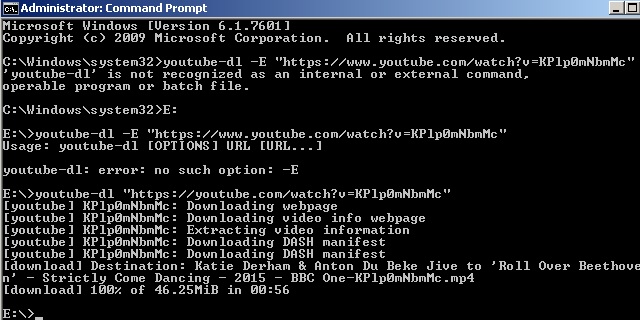

  6. Thanks, biezom, but I'm getting errors all over the place. What exactly should be entered in the Command Prompt - the instruction in the first line of your big attachment or the 'one line' attachment?
    UPDATE: I managed to get a download from youtube-dl as per the attached Command Prompt. What I got is the 1280 version rather than the 1920. As you can see, I didn't get 'Available Formats' like you did. Can you see where I'm going wrong? Many thanks.

  7. Originally Posted by pooksahib View Post
    [Attachment 34586 - Click to enlarge]
    -F not -E
    youtube-dl -F "https://www.youtube.com/watch?v=KPlp0mNbmMc"
    to see all available format
    after select your choice
    137 (video 1920x1080) + 251 (audio audio 132k)
    youtube-dl -f 137+251 "https://www.youtube.com/watch?v=KPlp0mNbmMc"
