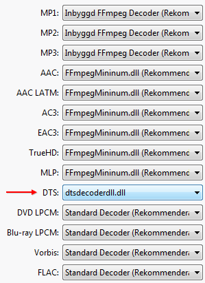

    Thank you. Would you help me figure out what to do, here's what I did so far:
    Copied both dtsdecoderdll.dll and Microsoft.VC90.CRT file to C:\Program Files\DAUM\PotPlayer\Module
    Then I started DAUM PotPlayer > F5 > Filter Control > Audio Decoder > Built-in Codec Settings >
    Now which of these needs to be changed to what and is there an additional file to be downloaded to get a TrueHD output too (and is the directory I placed it in correct)?

  3. Image
    [Attachment 34578 - Click to enlarge]
    No idea about TrueHD and I am not sure DTS works since you are using 64-Bit PotPlayer.
  4. Senior Member c627627's Avatar
    Kansas
    Thank you. You are correct. That screenshot only shows up in 32-Bit version.
    After installing the 32-Bit version and selecting it however, DTS-HD is still not being output so something else needs to be also switched I am guessing?
    I got no search hits on TrueHD so it appears that TrueHD cannot be used through Daum PotPlayer then?
    But if you have any ideas on what to modify to see DTS-HD please post...

    EDITED in 2022:
    Temporarily enable multi-channel / high definition audio playback:
    After all these years, I finally got around to figuring this out, particularly since applying any 2018 Windows Update on any version of Windows, destroys software Blu-ray players such as Arcsoft TotalMedia Theatre which no longer work on any Windows version updated in 2018 or later.
    *Warning*: Remember to set Pass-through to DISABLE after you finish (and select 2.0 Speakers) again, or else audio on some files will not work so I would not set this permanently, only temporarily to watch a file with High Definition Audio:
    F5 > Click on + next to Filter Control > Click on Audio Decoder > [On lower center] Click on Button that says: Built-in Audio Codec/Pass-through Settings >
    On the right, under Pass-through (S/PDIF, HDMI) > SELECT: Default Pass-through Muxer for each option [AC3, EAC3, TRUEHD, DTS, DTS-HD...] > OK > OK.
    This additional step is actually necessary:
    F5 > Click on Audio > [on the right] Speakers > Select your Speakers [do not select not "Same as input" for speakers because outside "input" may not be the same as your number of speakers!] >
    [below Speakers there is the option for] Output >
    Pass-through after AC-3 re-encoding
    or
    Pass-through after DTS re-encoding
    *Warning*: Remember to set Pass-through to DISABLE after you finish (and select 2.0 Speakers) again, or else audio on some files will not work so I would not set this permanently, only temporarily to watch a file with High Definition Audio.
    dtsdecoderdll.dll is no longer necessary on modern versions of Daum PotPlayer but for old versions of Daum PotPlayer:
    dtsdecoderdll.dll only works with 32-Bit PotPlayer, it does not work under 64-Bit PotPlayer.
    There is no need to install LAVFilters.
    You can directly use the dtsdecoderdll.dll with PotPlayer (as of v1.5.46096) or LAV Audio Decoder for decoding DTS or DTS HD [Lossless] streams.
    Copy dtsdecoderdll.dll and the related .CRT folder (otherwise it will not run if the related Visual C++ Redistributable package is not installed on the system) into base folder of the programs.
    Or you can simply copy them to folder C:\Program Files (x86)\DAUM\PotPlayer\Module
    To activate it in PotPlayer, select it from F5 > Filter Control > Audio Decoder > Button that says: Built-in Audio Codec/Pass-through Settings > DTS > dtsdecoderdll.dll
    > [on the right, under Pass-through (S/PDIF, HDMI) > SELECT: Default Pass-through Muxer for all.
