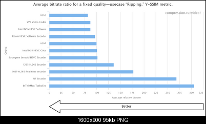

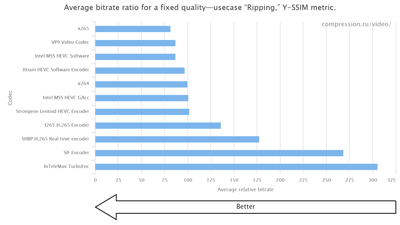

    As I said, HEVC was not a breaktrough
  3. I read through the pdf until my head started to hurt, but I think the gist of it was they tested a bunch of encoders using two different PCs (desktop and server) and they ran three different tests on each, supposedly comparing the bitrate each encoder required to achieve a fixed quality.
    One test had no speed restrictions, the second required a minimum encoding speed (although different for desktop and server) and the third required an even higher minimum speed, so in the case of x265 (and x264) the encoder's speed preset needed to be changed accordingly.
    It appears x265 was considered the best (in respect to bitrate) when there was no minimum speed requirement and still the best when the minimum speed requirement was fairly low and dropped to 3rd or 4th place when the minimum speed requirement was higher. It was interesting to see x264 was used as a reference point, and wasn't doing too badly, not all that far behind the better x265 encoders and better than some.
    One thing I'm still not clear on is whether 2 pass encoding was used for every codec or when it was, as was the case for x264 and x265, if the minimum speed requirement included the first pass or if it was just for the second pass.
    I'm not familiar with many of the encoders in the test, but I'm assuming this was a comparison of CPU based encoders only?

    I read through the pdf until my head started to hurt, but I think the gist of it was they tested a bunch of encoders using two different PCs (desktop and server) and the ran three different tests on each, supposedly comparing the bitrate each encoder required to achieve a fixed quality.
    One thing I'm still not clear on is whether 2 pass encoding was used for every codec or when it was, as was the case for x264 and x265, if the minimum speed requirement included the first pass or if it was both passes combined.
    And I'm not familiar with many of the encoders in the test, but I'm assuming this was a comparison of CPU based encoders only?
    Yes, they were CPU codecs tests. Imagine: the GPU and other HW encoders have even worse quality....
  5. I'm still trying to get my head around it a little in respect to how they tested. My brain expects to compare the quality of encoders at a fixed bitrate, but the test is comparing the amount of compression achieved for a fixed quality. I understand it can be done either way but I'm not sure how they determined the bitrate to use for a particular encoder (it seems to be a case of running encodes while increasing the bitrate until the target quality was reached) and I'm not sure why it'd necessitate using 2 pass encoding, at least for x264 and x265, which is why I wondered whether the minimum encoding speed requirements only applied to the second pass. It doesn't seem as though HEVC is setting the world on fire yet though.
    According to the pdf the "desktop fast encoding" test had a minimum speed requirement of 30fps, while for the "server fast encoding" test it was 60fps, and each time the medium preset was used for the x264 encoder, while for x265 the ultrafast preset was used for the desktop test and the superfast preset was used for the server test. Logically I'd have thought for x265 the speed presets would be the other way around (superfast for the desktop test and ultrafast for the server test), and the same preset each time for x264 doesn't make complete sense to me. The desktop and server PCs had completely different CPUs so maybe that'd explain it, but it doesn't seem logical on the face of it, especially as the "desktop fast encoding test" was the only one where x264 beat x265.
  6. Originally Posted by Stears555 View Post
    Well... it was also tested Intel GPGPU encoder (albeit this is not clear - not sure if this is real GPGPU or QSV encoder).
    From my perspective i saw some inconsistencies - same as in previous years - using PSNR or SSIM tuning where other encoders have no this kind of function or such function is not enabled seem to be not fortunate idea... glad to know reason behind such approach.

  21. So many things wrong with this test:
    A) They used Haswell based cpu's and then tested the Intel MSS HEVC encoder in software and Hybrid SW/HW mode. This gives a warped view of what the Intel HEVC encoder is really capable of, they should have tested with a Skylake as it's the first Intel cpu to support FULL H/W HEVC encoding; the speed and quality tests would have had different results.
    B) They used incorrect parameters for VP9. As noted by the VP9 developers MSU used the parameter --cpu-used=1, as noted a value of 0 would have improved compression by about 10%. Furthermore, VP9 has some advanced features, such as Golden I Frames, which allows the encoder to encode higher quality I frames which are then used as references for other frames; likewise VP9 also features the ability called spatial resampling which allows the encoder to encode a lower rez version of a frame and then upscale it during playback, often times this results in a higher overall quality, I do not believe this option was enabled for VP9 in this test.
    C) The test sequences are way to short; some are less than 400 frames long. X264 defaults to a 250 frame GOP and the developers specify a GOP length of 500 frames for the MSU test. That leaves in some cases 1 or 2 I frames for the entire sequence, which can and does unfairly impact quality measurements.
    D) The "Ripping" test features no minimum speed requirement, meaning that they were free to use "placebo" for both x264 and x265, settings that realistically are not an option for normal users, especially in the case of x265 encoding as it would take too long.
    E) Lastly it unfairly biases the test when you normalize for one codec, in this case x264. The test results should not be relative to one of the competitors, i.e. one competitor is 100% and everyone else is a percentage value of that competitor. A better test would be to test SSIM Global, SSIM Average, PSNR Global and PSNR average for all encoders at the same bit rate, i.e. 2000kps, 4000kps and so on.
    I consider this test an overall FAIL.
