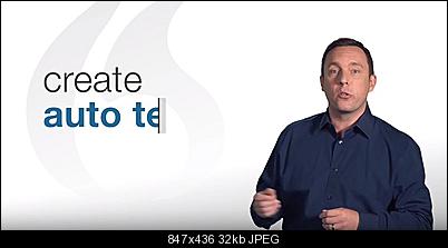

    How do I create the typing effect in the video? This one here:
    How would YOU go about it, step by step?
  13. Originally Posted by success17 View Post
    <snip>
    Several ways you can do it, such as with the text animator, using masks, or a wipe effect. There are tutorials and presets you can download that do similar things, but you might have to search to get exactly what you want.
    The most flexible method that allow the most control is a mask reveal. Notice in that video it's not strict per letter snapping such as a real computer or typewriter (ie. you can see "half" characters). That suggests wipe or mask method was used in that version also, not a per letter animator. (But you have full control using the internal text animator also.) You can think of it as the text already there on a layer, just not visible yet. It gets "revealed" by either animating a mask or even a wipe reveal effect. The keywords if you're looking for tutorials are "wipe reveal" or "mask reveal".
    The "command prompt" exists on a separate layer. The "flashing" of the command promp is just opacity keyframed from 0 to 100% to 0 and so forth. You can copy & paste keyframes to do this quickly, or there are expressions you can use to automate. I would stay away from expressions until you get the basics down (it's a scripting language for AE). There are actually 2 parts to the command prompt, a darker thin bar, and a lighter wider bar. Feel free to use your own styles, there is no reason you have to make it look the same as that video. The reason I say 2 parts (instead of a single graphic), is at the end of the animation on a particular "slide", only the dark bar is visible
    Another reason I would do it with a mask , is you can control the animation by parenting to a null object. This is a central , core concept used in animation. Think of it as "follow the leader". So you animate that 1 null object, everything else, all the layers linked to that null get "pulled" along with it. So if your command prompt was some complex creation on multiple layers, they would keep the same relationships as you animated the null (you wouldn't have to manually animate all those layers). This greatly simplifies and speeds up the amount of time spend animating. If you did it with the text animator method instead, you'd have to animate the "command prompt" separately, beacuse the text animators don't actually move layers in terms of x,y,z space (or you'd have to use some heavy duty expressions to get it to work) . The keyword here if you want more info is "parenting"
    EDIT: I called it a "mask" - as in mask layer - but I should use the proper term that adobe uses which is "track matte". Adobe uses "mask" to refer to splines on the same layer (ie. you click with the pen tool) . A track matte is a separate layer which controls layer visibility of another layer. A "luma matte" is a specific type of track matte where the white/black information controls the visibility of the other layer. 100% white means 100% visible, 100% black means not visible (and shades of grey are intermediate). So to clarify why I brought up the null object, I would parent the "command prompt" layer(s), and track matte layer to the null object, so all of them move together at once in the same spatial relationship . If it doesn't make sense or you can't find tutorials for it, I'll try to post a screenshot
