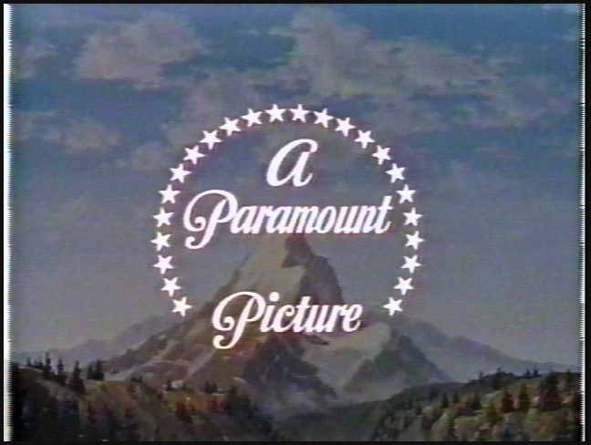

  1. Thanks for posting that. The OP now has something to compare.
    I've taken your advice, and tried a couple of 'tweaks' to my file (especially with the lower bitrate), but as you say, there's only so much you can do!
    Personally, I don't mind a bit of noise... and I tend to prefer the less saturated color look as well, so I probably use too little color!
    I tend to think there is a bit of 'silk purse and sows ear' about VHS, and it's all too easy to get into the realms of 'diminishing returns' - A lot of extra effort and expense, for ever smaller improvements.
    Having said that, there are some very impressive restorations of older films and videos....
    I can see that some footage is worth the extra effort.... probably not mine though!!

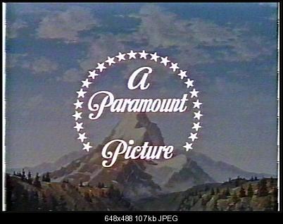

    Yes, tutmask2 looks smoother and better. Those little ripples, which are smaller now, always drive me nuts. Looks like there's still some scanline shift and some vertical jitter, but it could have been broadcast that way. Not having seen the original capture, I couldn';t say what to do for more fixing. It depends on the personal value you place on the it. Which reminds me....
    True. VHS doesn't have the resolution to make it look like DVD. At best you can keep VHS from looking too much like VHS. There is that point of diminishing returns, which I think I've just about reached with that sample of mine. I kept most of the original film grain but pretty much got rid of the dirt and other gunk that the cable broadcast put there. That cable installation was a horrible signal, with red jumping off the screen, so bad at times that I finally cancelled the service and lived on antenna for a while until I moved elsewhere. Even today I get direct DVD recordings off some digital cable channels that look as noisy as VHS, with really ugly compression artifacts to boot. So some of this stuff just has to be taken as-is with a quickie cleanup. Life ain't long enough for fixing all of it.
    Despite the crummy M&L quality of the original movie I posted, and despite that it's a corny, goofy movie, it has nostalgic value and some classic Jule Styne-Bob Hilliard numbers I've always liked. So that's the reason for the work. I guess I just prefer as clean a cap as I can get, since a bad broadcast or bad VHS print is trouble enough without worrying about problems added by a capture device. As a side note, I originally tried capturing that tape with the AG-1980 -- whose dnr made soft mush of it. Proof that having more than one VCR is the only way to go, and that full-scale onboard dnr ain't always an asset. The 4670 does have some minimal dnr but it looks like it works only on chroma. It doesn't have the oversharpening seen with a lot of machines, especially later ones. It's rebuilt, from an era when a lot of vcr's were built like tanks. Sometimes it's so smooth I think I don't need a line tbc pass-thru. But I use one anyway. Never can tell when a bad section of tape will pass across the heads.
    I still have the tape but not the original capture, only the ivtc version and the MDegrain2 files. Every tape is a problem, unique in its way. And every recorder. The reason for the black borders on the sample I posted is because of the way that old CRT-era RCA recorded tapes. In the modern day of defeatable overscan on HDTV's, you won't see side borders that look like these, from the unfiltered ivtc cap:

    Just another VHS pain in the...neck. And keeping that early 50's Technicolor intact is a problem in itself.

    Say, pippas, you have vision problems? That video is full of noisy fuzzies, and if you kept it interlaced and to spec for common commercial formats it would look worse. It's washed out, IRE is elevated, highlights are clipped, and you used the old make-it-double-rate trick to keep DV buzzing edges and sloppy interlace from showing up. You can see compression artifacts in her face during motion.
    Sorry. Not sold. Good thing you didn't pay to have it done. Why didn't you post something from the original?
    What's with the odd frame size?

    I found that a progressive, square pixel, x.264 encoded format - in an mp4 wrapper - seemed to suit my replay options best ( PVR and TV USB inputs - WD player - computer replay).
    The odd frame size allowed me to cut out the unsightly borders, while still retaining square pixels. I do not then need rely on any aspect ratio 'flags' being present, to correct non square pixel files.
    I have no interest in 'burning' any more optical discs, so I have no need to be restricted to any specific frame size.
    I have read that it is often advised that interlacing should be retained, but I have had variable results from different players with interlaced files, so tend to make my final encoded files progressive. Doubling the frame rate seems to keep motion 'smoothness' similar to the original interlaced files.
    As the files are for my own use, and not for any formal 'archiving' purposes, the format seems to work OK for me.

    After adding deinterlacing artifacts and another round of DCT compresssion artifacts with h.264 encoding one can't point to specific artifacts that were created by the original DV encoding. I can only tell you that there would be fewer artifacts had you captured with lossless compression.
    I agree with that, or most of it up to a certain point -- it's like asking which component holds the smoking gun. IMO, a lot of the DCT stuff is in the tape.
    Being nicer about the matter than my earlier post -- sorry, folks -- and getting more specific:
    My main contention with the DV sample is that it's not made from an under-powered, noisy cable broadcast with a cheap RF amp in circuit and cheap RF cables on a cheap VCR, or from aged and overplayed consumer-photographed home tapes made with horrible consumer gear and low-rent lenses. Instead, it's a relatively decent recording made from a signal created and transmitted by professionals. That broadcast couldn't possibly be as crummy and noisy as a typical Hi8/analog home video.
    The noise I refer to is fuzzy, buzzing stuff around small objects and intricate patterns, especially when those objects move. I note particularly the woman's red jacket and the burned out highlights of the white blouse, flickering noise in the red when the woman's left shoulder moves, and aliasing in the shoulder stitching of her right shoulder (your left). You do find a certain amount of that noise on tape itself but not as much as I see here, especially with progressive video and denoising. This dancing noise is an old acquaintance from years of watching tape-to-DV captures. I often see it in DV originals. It can be cleaned a bit, but a lot of video will fall off the edge on the way there. DV capture usually looks kinda denuded or overfiltered, as this one does, so I guess the tradeoff is living with the noise. The posted sample looks a lot better than a typically noisy home tape capped to DV.
    The more aesthetic matter is that, in my humble view after years of correcting photos and processing film and negatives some years ago, there is something wimpy with DV color. It always seems a bit transparent to me, or unrealistic, a vague feeling that something's missing or has been rounded-off too much. Subtely of tone and fine, textural detail are not DV talents. Maybe that's just me, but if you try to add saturation to the thin-looking DV sample you'll see some loco things happen to separate colors and the overall balance.
    I guess that's as detailed and specific as I can make it without getting into highfallutin' language such as used by Poynton and the big boys.

  24. Yes, if it was never digital before being recorded to VHS tape it couldn't have DCT artifacts. Even it it had been digital before recording to VHS tape the low resolution of VHS tape would have blurred much of the DCT artifacts away.
  25. The posted clip was from a tape made of a BBC program, broadcast here in the UK in the early 1990s. So none of the DV artifacts are from the original broadcast file ....
    The broadcast was recorded onto a simple consumer VCR - long since dead - and that clip was made from the tape being played on a similarly aged consumer VCR. So no 'pro' gear involved (obviously, I hear you say! ).
    I only have a Canopus converter - or a DVD recorder - to make my transfers. So far I prefer the results from the Canopus, but am grateful for the comments here that help educate me, should I wish to move a little further up the video capture 'ladder', in the future...
  26. This post shows some DCT ringing artifacts from DV encoding:
    https://forum.videohelp.com/threads/294144-Viewing-tests-and-sample-files?p=1792973&vie...=1#post1792973
    That wasn't a VHS tape but a pristine digital video encoded with a software DV codec. Bit it shows you what to look for. All DCT based encoders deliver artifacts like this (JPEG, MPEG, Xvid, AVC, etc.).
  27. Thanks for that link. Fascinating thread.... and shows me exactly what to expect DV artifacts to look like.
    So, if all DCT based encoders deliver such artifacts, does that mean that Wavelet based codecs like Cineform are immune.... or do they have their own - but different - artifacts?...
