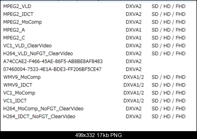

  1. If you watch the CPU usage - everytime you spike to 100%, you drop frames, so playback won't be smooth.

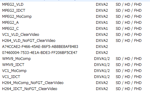

    Does that integrated chip have any video playback support, maybe through DXVA ? Download DXVA Checker and check
    The T3500 is an early generation dual core penryn. It's insufficient for 1080p59.94 AVC CPU decoding. Maybe consider 720p59.94. You can also use something less compressed, and/or less compressed h264 settings such as --tune fastdecode in x264 with appropriate vbv settings , and short GOP. MPEG2 is easier to decode as well, and is cineform that I mentioned earlier.
    Apr 2012
    Hungary
    It shows this listing:

    You might have to configure some things in your media player to use DXVA, or there might be some limitations on certain profiles / framerates and resolutions
