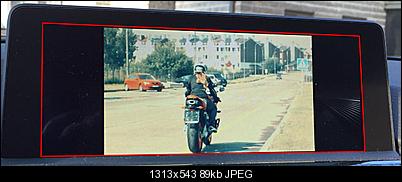

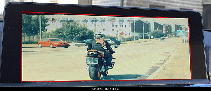

    If my interpretation of your picture is correct, your newly encoded video is distorted -- stretched horizontally. A 16:9 video is not supposed to fill a 2.6:1 screen. I'm assuming this red box outlines the 1280x480 screen:
    So the screen is ~2.6:1. And the picture from you original encoded video in the middle has the correct aspect ratio, 16:9.
    Yes, the red box does outline the 1280x480 screen.
    So how do I get to have my cake and eat it too? Have the video fill up the entire screen and not be distorted?
    Should I set the aspect ratio to 2.6:1 when encoding with vidcoder?
    Thanks!

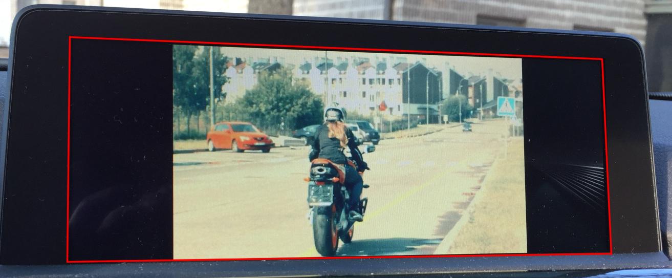

    You can distort the 16:9 video or you can crop off the bottom and top. Either way you ruin the video. Or only watch 2.35:1 movies -- they'll nearly fill the screen after cropping off the black borders.
  19. Member Cornucopia's Avatar
    You DON'T have your cake & eat it too. You make a difficult choice (hopefully one that doesn't bastardize the original intentions of the clips' creators).
    If you make it the same size as your 2.6:1 screen it'll look like this (stretched)...
