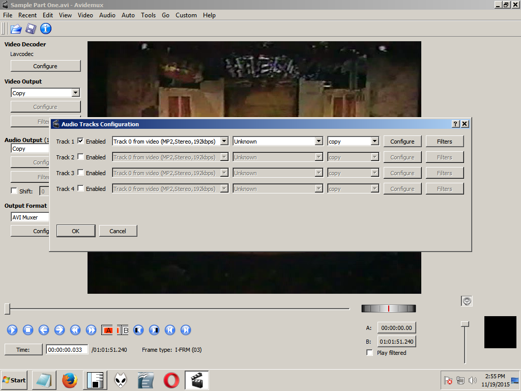

  9. My screenshot with a sample file loaded and audio window opened:

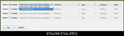

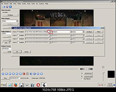

  10. click the triangle, the drop down box, select add audio track
    I circled it in red

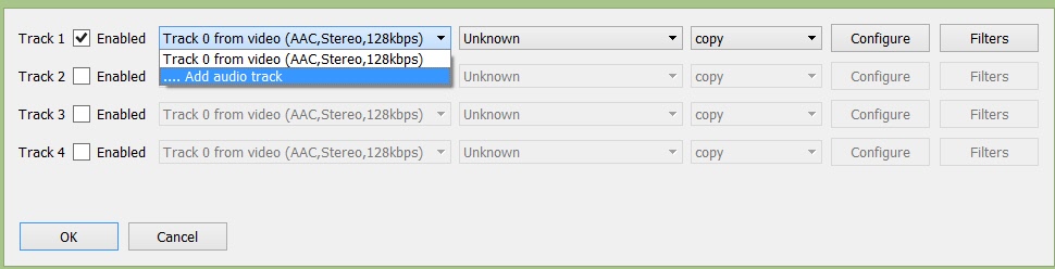

    It will look like this, then you navigate to the new audio file
Name:	add audio.jpg
  11. Originally Posted by poisondeathray View Post
    I circled it in red
    [Attachment 34565 - Click to enlarge]
    [Attachment 34566 - Click to enlarge]
    Great. I have to admit I would have been hunting for a long time for the right triangle.
    Will print it off and report back any success.
    I have another job in the queue where AVI Demux should work.
    Thanks for taking the time and patience to explain this.
