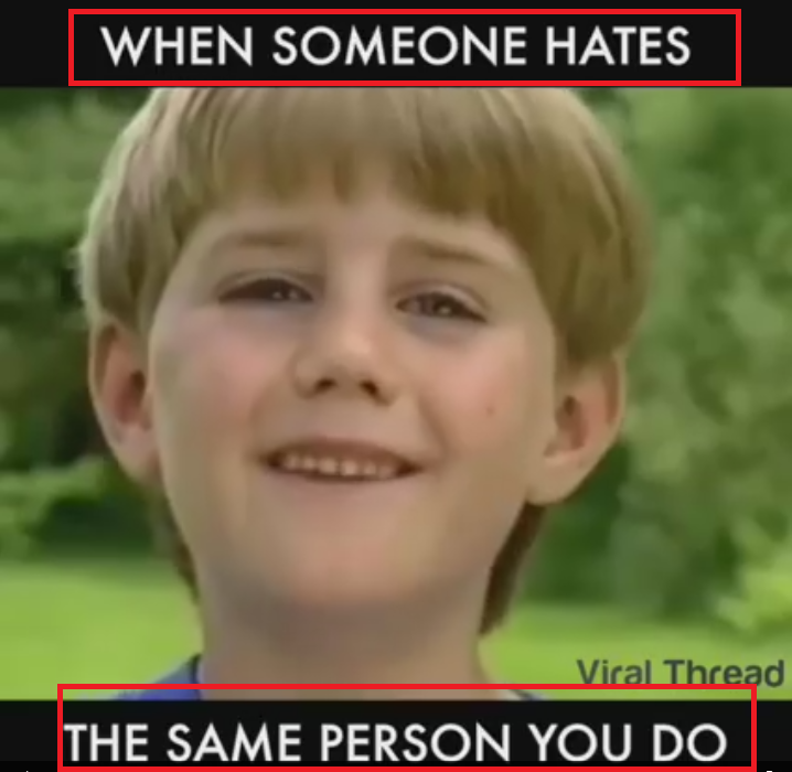

  1. Like this video for example
    https://www.facebook.com/viralthreaddotcom/videos/vb.363765800431935/810780072397170/
    I want to do the same thing
    I talk about these titles:
    I will appreciate your help

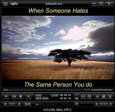

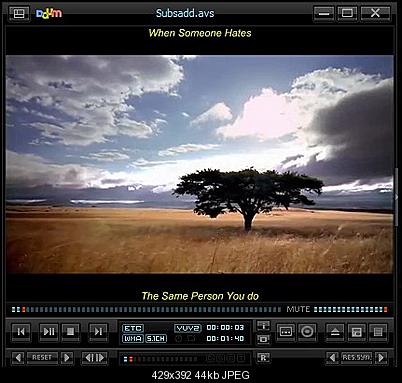

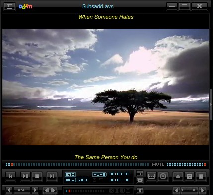

    Just to add a little extra info... If you want that size font, the easiest way to adjust the size is adjust the PlayResY setting in the SSA file. The following 436x234 video shows settings of 240 and 480 for PlayResY.
    [Script Info]
    Title: 'subtitler' filter demonstration
    Original Script: Someone@somewhere.org>
    ScriptType: v4.00
    ScaledBorderAndShadow: yes
    Collisions: Normal
    WrapStyle: 0
    PlayResY: 240
    PlayDepth: 0
Name:	ScreenHunter_181 Nov. 14 17.27.jpg

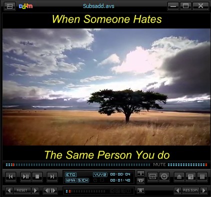

    [Script Info]
    ScriptType: v4.00
    Collisions: Normal
    WrapStyle: 0
    PlayResY: 480
    PlayDepth: 0
Name:	ScreenHunter_181 Nov. 14 22.20.jpg
