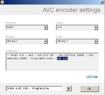

  9. I didn't understand half of that. Like, why is Handbrake even in the equation, if you're using AviSynth.
    Back on Ripbot, it's doing all sorts of odd things. I've seen it stretch the video to be 16:9 when it's supposed to be 3:2,
    Then check your SAR settings and change to 1:1 if need be. If you can't get the subs into RipBot264, mux them in afterwards using MKVMerge GUI, during whch time you should be able to create the chapters as well.
    I use Lagarith for lossless AVI. The sizes produced are among the smallest among the lossless AVI codecs. If you complain about the file sizes, maybe it's time for a new hard drive. Otherwise, just take the AviSynth script and encode drectly from it. Always test your scripts in VDub before sending them to the encoder. And I haven't much interest in helping anyone encoding from an MKV whose source is DVD when it's much more reliable to use MPEG2Source. Good luck.
