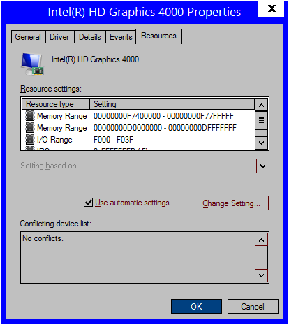

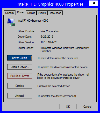

  6. What does the driver tab say ? What driver version and date ?
    Does the resources tab show any conflicts ?
  7. No conflicts
