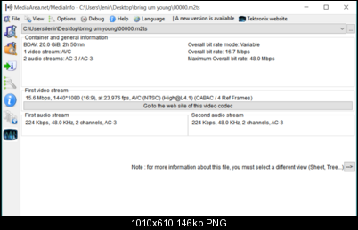

    So I have a couple of h.264 BR rips and I am trying to convert them to mp4. I have ripbot and as I'm speaking one of my rips is in the process of being converted to mp4. I did some searching and so I used media info to get the bitrate info:
Name:	Screenshot (131).png
    so in ripbot I selected the 2 pass option and put in 16,700 for the kbps. So far 5 hours have passed and there's about 8 more until Pass 2 finishes. I realize this is a very long time so my questions were:
    1. Did I input too much for the kbps?
    2. Setting it as high as I did will I get the exact or close to quality of the actual rip?
    and lastly:
    3. Did I do this all wrong?
    thank you guys
    EDIT: My purpose for ripping the exact size of the file to a different container is my own personal preference. I plan on ripping smaller sizes as well just in case anyone was wondering.
