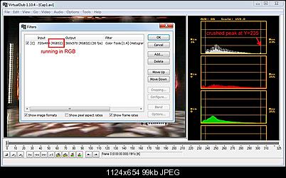

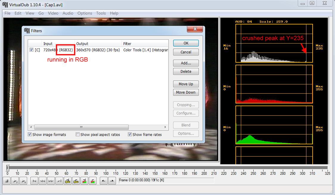

    You can't really use Color Tools in VirtualDub to judge levels. Since it works in RGB (after a standard rec.601 conversion from YUV) any super brights (Y > 235) will be crushed to RGB=255. The best you can do with Color Tools is look for a peak at the top and bottom that implies crushed blacks and brights.
    Color Tools:

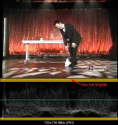

    The big peak at Y=235 is a little hard to see because it coincides with the orange line.

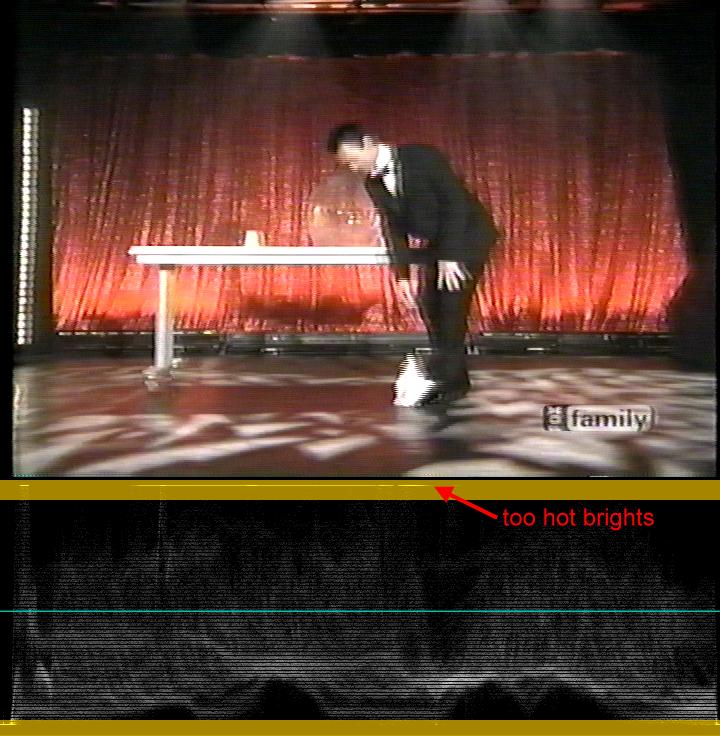

    AviSynth HistogramOnBottom() (really a waveform monitor):
    The super brights are from the table, the handkerchief, and the bright lights near the left edge of the frame. Those brights are crushed to Y=235 when converted to RGB (255). That's not highly consequential in this shot but it could be in others.
    The waveform shows superblacks too but they are mostly in the front/back porch which doesn't matter (though you would want to check a wider range of video since the porches are supposed be be at Y=16) and a few oversharpening halos.

    The brights are too bright in all three caps. The black level look about right.
    Color Tools:

    So are you saying instead of using Color Tools in VirtualDub, use AviSyth's HistogramOnBottom() filter?
    Yes. Or just Histogram(), or TurnRight().Histogram().Turnleft().
    Originally Posted by Micheal81 View Post
    Create an avs script with that filter and run it throught VirtualDub?
    Yes. I always use VirtualDUb to view the results of my scripts.
    VirtualDub's capture module also has a (true) histogram that you can view while previewing. It's much easier to use that since you get live feedback. So you don't have to capture, check, make proc amp adjustments, capture again, check again, etc.
    With most capture devices you can change the proc amp settings while previewing. To do so you need to use GraphEdit or GraphStudio, add the capture filter, go to the filter's settings dialog, and adjust proc amp the settings. You'll see the changes live in VirtualDub.

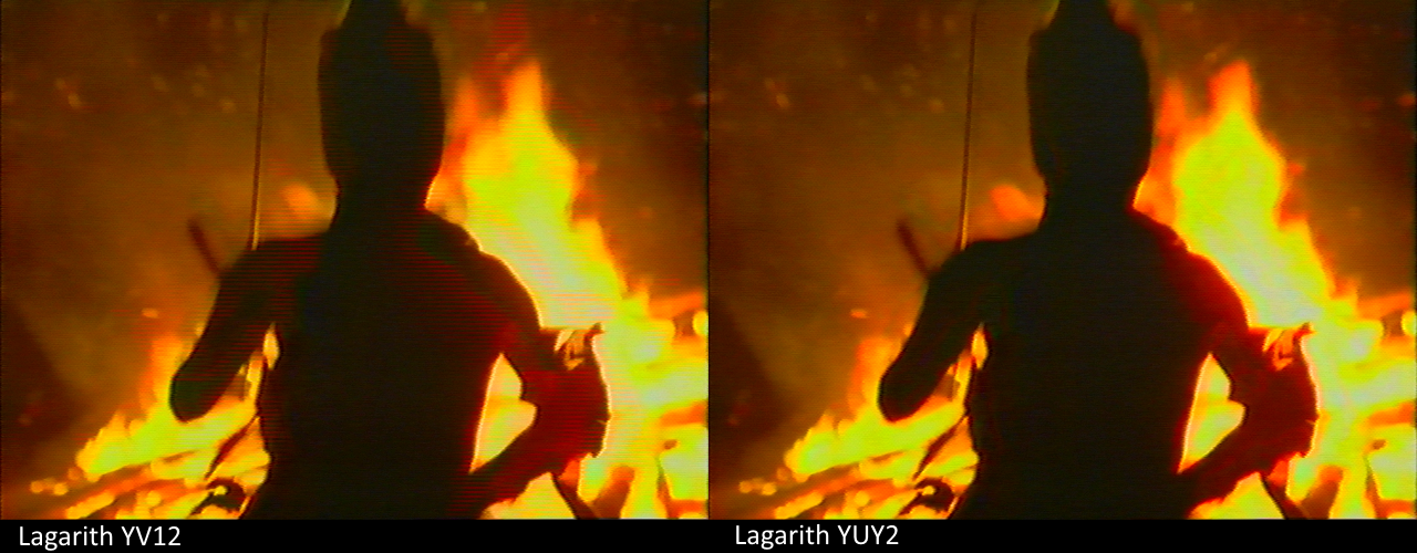

  26. Dinosaur Supervisor KarMa's Avatar
    Jul 2015
    US
    Ok poisondeathray, you have convinced me.
    I captured a fire dance scene twice on VHS, with my YUY2 card. Once with Lagarith YUY2 and then again with Lagarith YV12. The video required detelecining.
    I've seen this before with my previous captures, at least with material that required detelecining. Messing with TFF and BFF never did anything to help so I just assumed it was just a problem with the VHS format. Now I know.
    Truely interlaced material is less noticable to me, besides maybe some ghosting on scene changes. But I'll still stick with YUY2 for capturing.
    Used AvsPmod to capture PNG images with below avisynth scripts.
     AVISource("O:\YV12.avi")
    LoadPlugin("O:\Megui\Megui\tools\avisynth_plugin\TIVTC.dll")
    tfm(order=1).tdecimate()
    crop(12, 0, -6, -10)
    Spline64Resize(640,470) # Spline64 (Sharp)
    AVISource("O:\YUY2.avi")
    converttoyv12()
