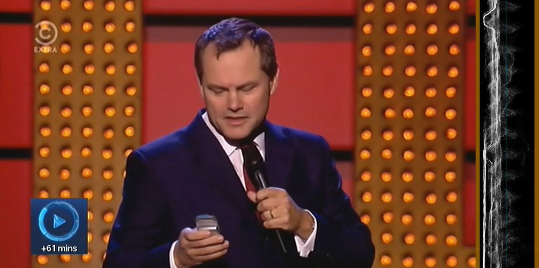

  7. P.S. This image shows a Waveform Monitor view of the levels for your "S-Video Default Brightness as Source.ts" sample. I actually find the waveform display more useful than a histogram for monitoring and correcting luma levels. Most software that can generate a histogram can also generate a waveform. As you can see, the "0" level is indicated by the vertical red arrow, and the other arrow points to the blacks in his shirt. Almost all the shirt levels are below the zero level and are therefore "crushed:" all detail has been lost, forever. You cannot increase the gain and recover detail.
    The levels on most of your other samples do not show this, although there are various shifts, up and down in these other samples, some of which are probably not correct.
    This display is easy to understand. The left to right corresponds with the left to right in the video itself. The vertical indicates the brightness (luma) value of every pixel in the vertical column of pixels at that location. Thus, to the left and right of center each column of round lights show in the display as big vertical humps with maximums around 25-30, with just a little bit of much brighter pixels (around 60) which come from the bright dot in the middle of each bulb. A brighter display at any location indicates that lots of pixels in that vertical column have that same luma value.
    There is another, "next level" discussion about what levels of 0 and 100 mean, but you need to get started down this path before we start worrying about that.

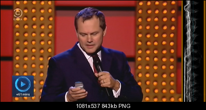

    I used histogram("mode=classic") in AvsPmod which adds a Waveform monitor. Here's a screenshot: Click image for larger version
    However I don't see the numbers on my graph so how do I know what levels are correct or not?
    Is there anything I can do to lower the brightness of the whites on the shirt without effecting the rest of the clip?
  11. Your AVSPmod waveform display works in the vertical direction, rather than horizontal direction shown in my example. That's OK, and it would still be useful if only it had some calibration information. However, without a scale, it is pretty much useless, as I think you've already figured out. I did a quick scan of the documentation, and it appears this was added as an afterthought, after the developer received some requests, but he never really put his heart into it.
    As for your specific request, to change just the luma values that fall within a given range, you typically want some sort of histogram curve tool. What such a tool does is to map each luma value to a new luma value. A diagonal line makes no change at all, which is what is happening to the dark through intermediate brightness pixels in the screenshot below (note that the lower left quadrant of the display is a perfect 45 degree diagonal line, so the brightness of the darker pixels are left completely unchanged). This snapshot shows the histogram feature working on your best capture, and reducing only the really bright pixels.
    Another way to do this is to use a tool which lets you specify specific ranges of luma and chroma values, and then modify any pixels that satisfy these conditions. This is the tool that lets you, for instance, replace one color with another. Here is an example of what this looks like, using the tool in Sony Vegas Pro:

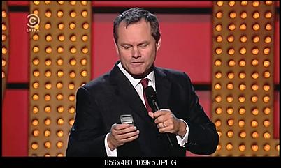

    May 2014
    Memphis TN, US
    Blue is oversaturated.
    Gamma is too low.
    You can control high brights with Levels. Try Levels(16, 1.0, 255, 16, 245). SmoothLevels would be better.
    Raise gamma.
    Reduce blue saturation.
    Raise red saturation.
    Tweak in RGB.
    Use full-color waveforms or parade histograms to check individuals colors.
    Calibrate your monitor.
    That suit in the image in post #10 looks like neon blue velour. And, yup, some dark blues are crushed.
    Visit some free Photoshop tutorials and learn color and tone theory, or you'll go bonkers.

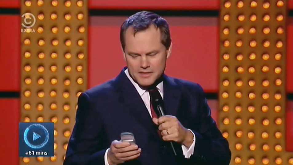

  13. Because his hair is bluish, I think he probably has a blue spotlight shining from above and his suit could really be black, for all I know. Or maybe not quite that 'purply' shade of blue. Trying to change the colors in that scene might throw off the colors in others. One would have to see the entire thing to be sure, I think.
    May 2014
    Memphis TN, US
    The "real" colors area tough call. Color in all the captures looks pretty weird. Then add posterizing in the Elgato caps and even skin tones look screwy. It could just be the broadcast for all we know. The long captures that have views of the audience look weird, too, with that side shot of the audience applauding looking like orange neon. I think everything in the originals is over saturated besides being too contrasty.
    Note in next to the last shot in HDMI Sample Default Brightness as Source.ts from post #1 that there are blue overhead backlights behind the guy onstage. Colors and lighting look, mmm, what we would call "tacky" down south where I come from. But a lot of copycat talk shows look that way.

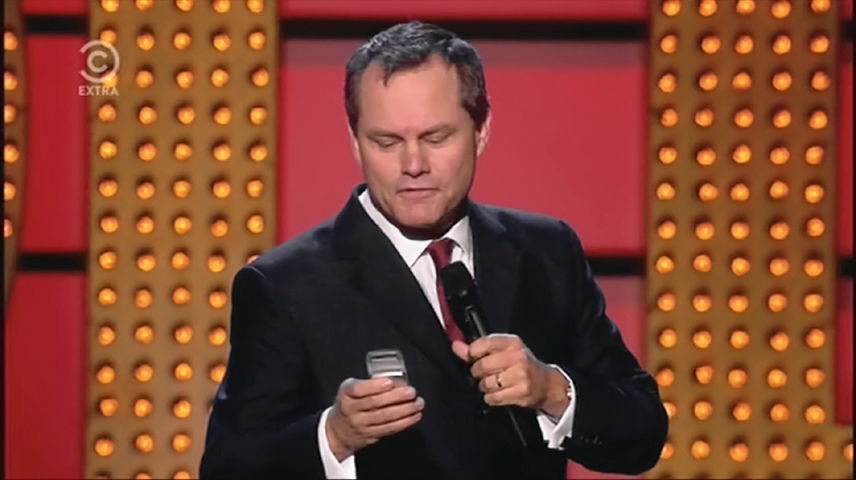

    Played with the HDMI default capture this A.M. until I got sick of the damn thing. You can make the darks brighter if you want but they'll just look washed out with no detail gain. The miserly 6K bitrate didn't help. That crushed suit is pretty murky and noisy with the kind of discoloration usually seen in crushed colors (here, it was magenta blobs). I used SmoothUV and TemporalSoiften to clean it a bit. I don't know how the capture is set up, but AAC audio ain't valid for DVD/BluRay/AVCHD. Fixed levels in Avisynth with ColorYUV and SmoothLevels, then color and whatever else in RGB. You can make it look however you want. I didn't have the patience to cool line twitter. It's a mess.

    Or if you want (WTH) you can tame RGB blue to nearly nothing and make the suit go black. But...other things look kinda kinky (like skin tones), the suit still has blue haze sometimes, seems to want to go green, has even less detail, and looks blotchy. I guess we'll never know.
    - My sister Ann's brother
  20. Hehe, and his hair's not blue any longer.
