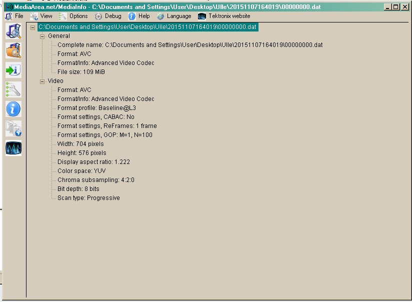

    Try loading dat file in mediainfo.
    May 2003
    Peterborough, England
    It would appear to be AVC?
