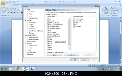

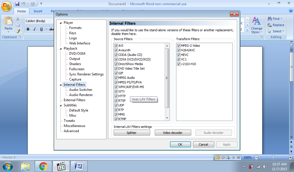

    1. The Audio Decoder tab is NOT highlighted. How do I access it?
    2. What is your reason for owning an Ipad/tablet? I never understood the marketing for this gadget. It does not fit in one's pocket and does not have the functionality of a laptop ( my future laptop will have touchscreen). The Dell rep (not that's saying much) could not explain the difference in functionality of a 2n1 vs a laptop with touchscreen. Obviously it comes apart, so...
    MPC-HC (Nightly)
    Build information:
    Version: 1.7.9.181 (b107b95) (develop)
    Compiler: MSVC 2013 Update 5 (SSE)
    Build date: Oct 5 2015
    LAV Filters:
    LAV Splitter: 0.66.0.27
    LAV Video: 0.66.0.27
    LAV Audio: 0.66.0.27
    FFmpeg compiler: MinGW-w64 GCC 5.2.0
    Operating system:
    Name: Windows NT 6.1 (build 7600)
    Version: 6.1
    Hardware:
    CPU: Intel(R) Atom(TM) CPU N455 @ 1.66GHz
    GPU: Intel(R) Graphics Media Accelerator 3150 (driver version: 8.14.10.2117)
  17. 1. It's a button called "Audio decoder" in Options -> Internal Filters -> right bottom corner (as earlier mentioned) in MPC-HC. What's wrong with that button? I should be clickable. Let me know if you need some help.
    2. To be honest, I got the iPad Air 2 from my relatives living in USA (I'm from bavaria) so we can do Facetime. Facetime is free and there are lots of cool apps for the iPad. I'm going to buy an iPhone, because I'm not satisfied with my Android phone (very expensive Note 4) and iOs is very nice.
  18. Banned
    Oct 2015
    1. Yes I know. Not clickable, not highlighted like tab next to it is for "Video Decoder" ...
    2. Iphone is nice, it fits in your pocket. I had a G1 once, and gave it away. Too much time spent holding the little thing.
  19. Which version do you have and where have you downloaded it, I hope not K-Lite
  20. Banned
    Oct 2015
    Yes Klite. latest...I posted all the version info. 2 posts up.
  21. K-Lite is not MPC-HC! They have a modified version without internal filters. Deinstall that crap and download the latest nightly from the developers site https://nightly.mpc-hc.org/
  22. Banned
    Oct 2015
    see
  23. Banned
    Oct 2015
    K-Lite is not MPC-HC! They have a modiefied version without internal filters. deinstall that crap and download the latest nightly from the developers site https://nightly.mpc-hc.org/
    I c, do you recommend still having all the codecs they provide or do I have to search for all those individually? Do I have to uninstall entire klite pack or just the MPC
  24. NO need for K-Lite crap. Trust me. MPC-HC has built in LAV Filters which covers 99,99% of all formats, codecs ...
    Deinstall K-Lite completety, it's not the original version with LAV Filters
