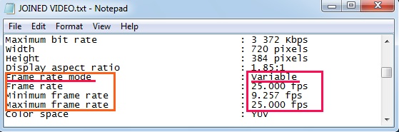

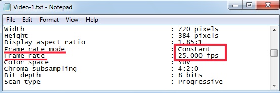

    Hi,
    I have edited some video files in VirtualDub and saved them using external encoders. Those are MP4 files with identical CONSTANT frame rate, resolution, encoded with crf 20 and around 20 minutes long. I tried joining the videos using FFMpeg. The output video came out with VARIABLE frame rate the reason for which is not known to me. I also tried avidemux, MP4box and I get the same variable frame rate video. But, I get constant frame rate when I join them using MKVToolnix. Again, I need to convert them to MP4 due to compatibility issues with the players. Can anyone suggest methods to get constant frame rate after joining!.
Name:	JOINED VIDEO.jpg

    The CONSTANT frame rate becomes VARIABLE frame rate as shown in the jpg file attached in the #1

    I followed what he meant and the video joined using mkvtoolnix i.e mkv file came with constant frame rate. This when remuxed to MP4 using the command given resulted in variable frame rate that is what is shown in the jpg file.

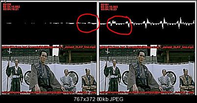

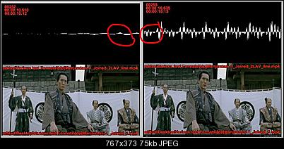

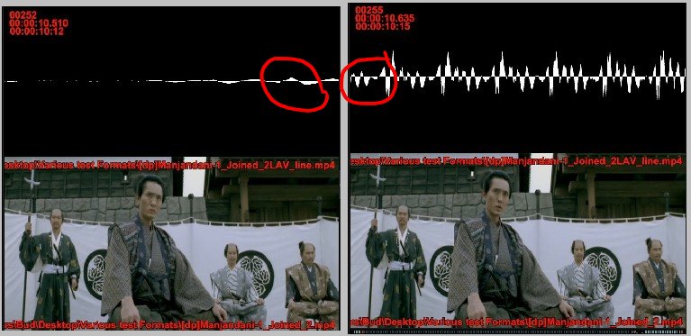

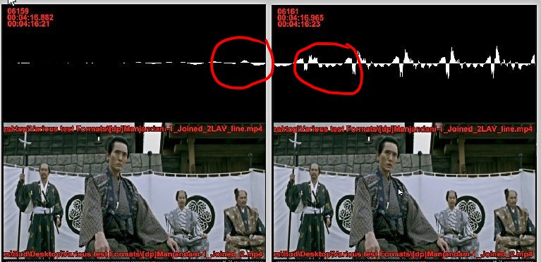

    Most of my MP4 are shorter videos so it is hard to tell visually but if I graph them out there doesn't seem to be or very slight. It's hard to tell if I am looking at the same frame generation but I'd say if my program is working correctly, audio is delayed maybe .002 ms in 4 minutes. This is based on .041 ms per frame (23.976 fps) and difference shows approximately 20 pixels out of 375 shift or .002 ms delayed
Name:	ScreenHunter_179 Nov. 06 10.47.jpg
ID:	34350Click image for larger version
Name:	ScreenHunter_180 Nov. 06 10.47.jpg
