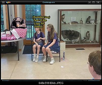

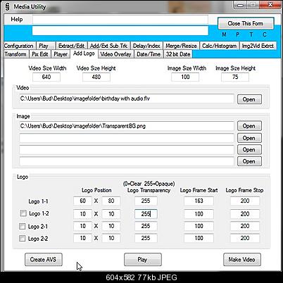

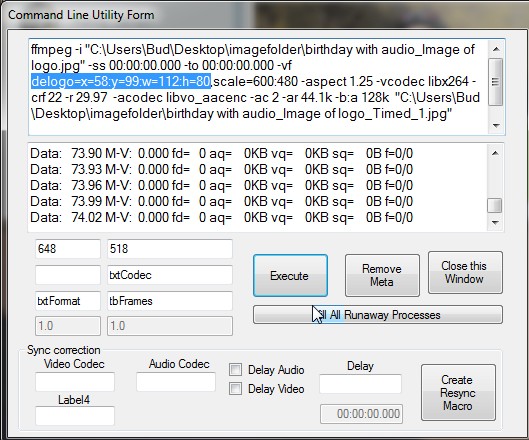

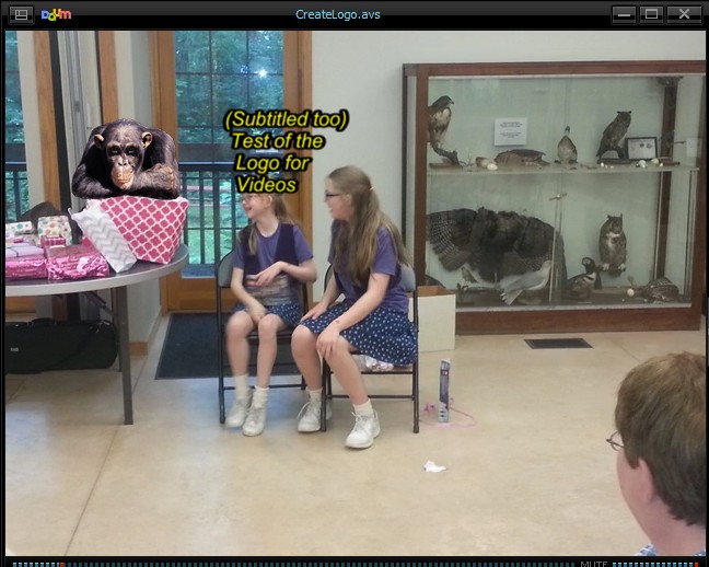

    Obviously, when you asked to use my program that uses ffmpeg as Baldrick suggested you were again shotgunning in all directions.
Name:	ScreenHunter_177 Nov. 04 08.32.jpg
ID:	34327Click image for larger version
Name:	ScreenHunter_177 Nov. 04 08.33.jpg
ID:	34328Click image for larger version
Name:	ScreenHunter_177 Nov. 04 08.30.jpg

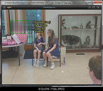

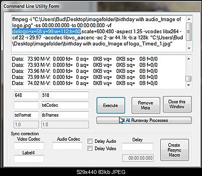

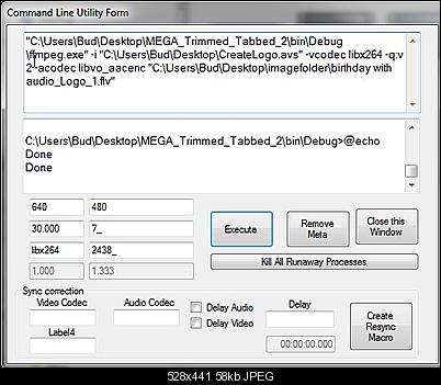

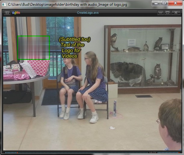

    As far as just getting rid of them because they are mostly eyesores, you can 'Smear/Smooth/Blur,etc.' them so you can't tell what they were but there's no way to replace an image behind them since nothing can tell what used to be there after the logo was added.
    Name:  ScreenHunter_177 Nov. 04 13.08.jpg
Size:  18.0 KBClick image for larger version
Name:	ScreenHunter_177 Nov. 04 13.03.jpg
ID:	34335Click image for larger version
Name:	ScreenHunter_177 Nov. 04 13.11.jpg
  8. Originally Posted by Budman1 View Post
    ...but there's no way to replace an image behind them since nothing can tell what used to be there after the logo was added.
    Kind of depends on the logo. The 'see-through' ones can be removed more or less successfully.
