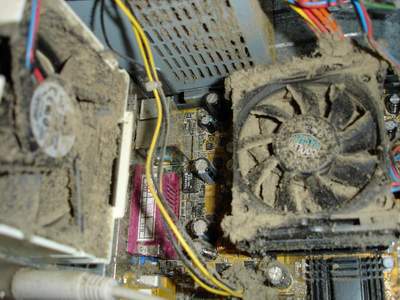

    Dust problems? I found this photo from a member a few years ago.
    Image Attached Images

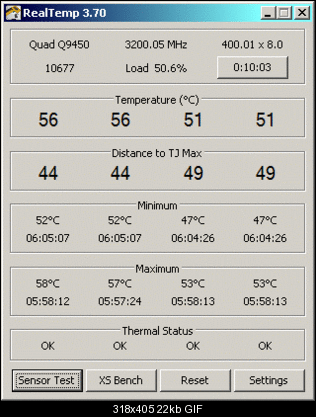

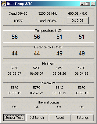

    The current state of my old Q9450. CPU usage is sitting on 50% running a single threaded QTGMC encode, although it doesn't get all that much hotter running at 100% as the CPU fan speed increases accordingly and I'm using a larger cooler than the stock one. Still, at the moment I've got at least 45 degrees of headroom before the CPU would start to throttle.
    Plenty of times I cleaned out inches of dust covering heatsinks etc and told myself off for letting so much of it build up, as after it's removed the CPU temperature drops a little which means the fan speeds drop a little and the computer makes a bit less noise, but an increase in processing speed.... I've not see that yet.

    The current state of my old Q9450. CPU usage is sitting on 50% running a single threaded QTGMC encode, although it doesn't get all that much hotter running at 100% as the CPU fan speed increases accordingly. Still, at the moment I've got at least 45 degrees of headroom before the CPU would start to throttle.
    [Attachment 34627 - Click to enlarge]

  27. Member
    Aug 2006
    I have seen horrible dust accumulation in a PC owned by relatives, and by that I mean worse than what is shown in Redwudz's photo. The PC in question was near a cage housing a pet c*o*c*k*atiel, which generated an amazing amount fine debris for one small bird.
    It was bad enough that I would not have been surprised if there were some heat issues, but I wasn't looking for them. I had opened the case up to install a hard drive. I needed to take the PC outside and clean it so I could do the work. I told the owners to check for dust now and then although I don't think that was ever done. This same PC did actually catch on fire at a later date. When I asked about dust inside the PC the answer was "I don't know".
    You're making me think and wonder if it was my cats creating that "debris" in my machine that time from my experience mentioned about a machine having a performance boost after cleaning and upgrading the cooling.
    I've been habitually blasting my machines with compressed air since, so I'm now wondering if what would pile up in there otherwise would indeed be cat residual, and not just "ordinary dust".
