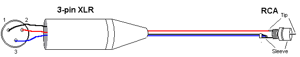

  4. You can go from balanced XLR to unbalanced RCA with loss of 6dB Click image for larger version

    not a problem i assume nowadays... anyway - always you can use balanced to unbalanced converter such as transformer - perhaps Jensen http://www.jensen-transformers.com/product/pc-2xr/ or similar HQ audio balun or modern active converter - for example something based on http://www.ti.com/product/ina2134/description or more traditional design.
    You can also capture audio on 4 channel input card - then you can perform balanced to unbalanced conversion in digital domain (quasi differential) - you should be able to improve overall SNR by 3dB.
