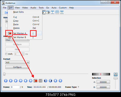

    Are you asking how to mark a section and remove it from the video? It's pretty much the same as in VirtualDub. You find the start of what you want to cut and Edit -> Set Marker A. Find the end of what you want to cut and Edit -> Set Marker B. Then Edit -> Cut. Repeat for each section you want to remove. Then File -> Save -> Save Video.
    Those instructions use the menus but you can see the equivalent button images and keystrokes in those menus:

    Download the Matroska source filter for VirtualDub -- the VirtualDub page here has links to it. Put Matroska.vdplugin in VirtualDub's plugins32 folder. You can now open MKV files with VirtualDub. You still might need a VFW decoder for the codec used.

    [Attachment 34338 - Click to enlarge]
    I just saw this and yes thanks for the detailed graphic. I'll go over it shortly. I'm slow to tackle new software. I takes me a long time to get it memorized or copied down.
    This may need clarification: I want to make two files at the edit not delete something. MKVMerge was good at simply making two files one called 001 and another called 002.
    I have to print this off and will do that and ask any followups.
