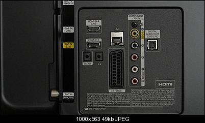

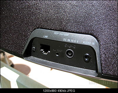

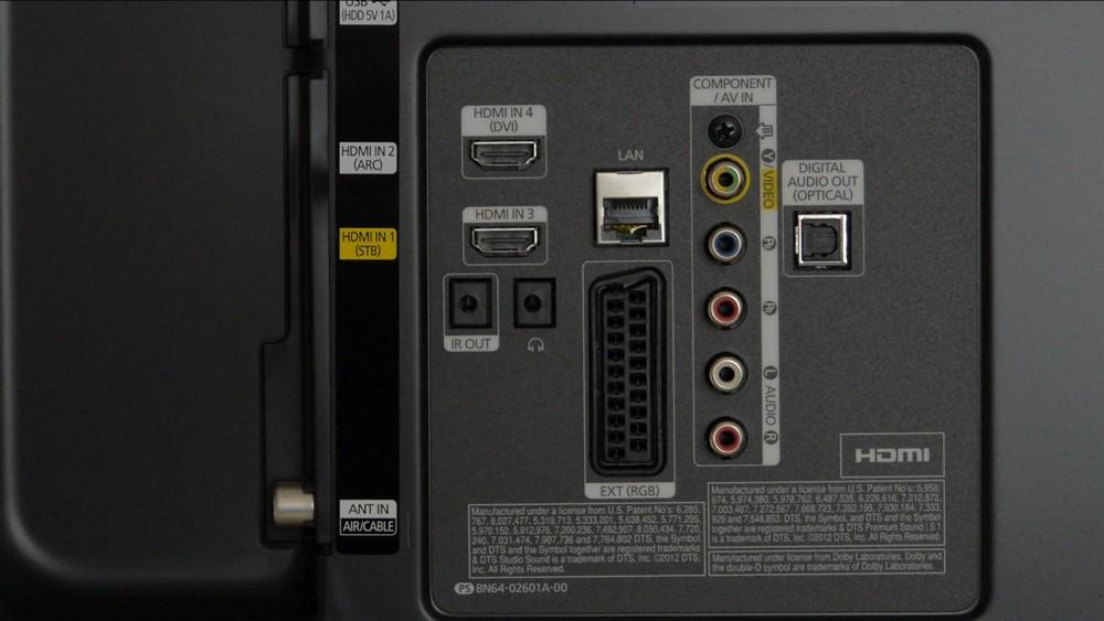

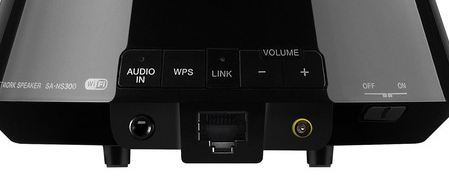

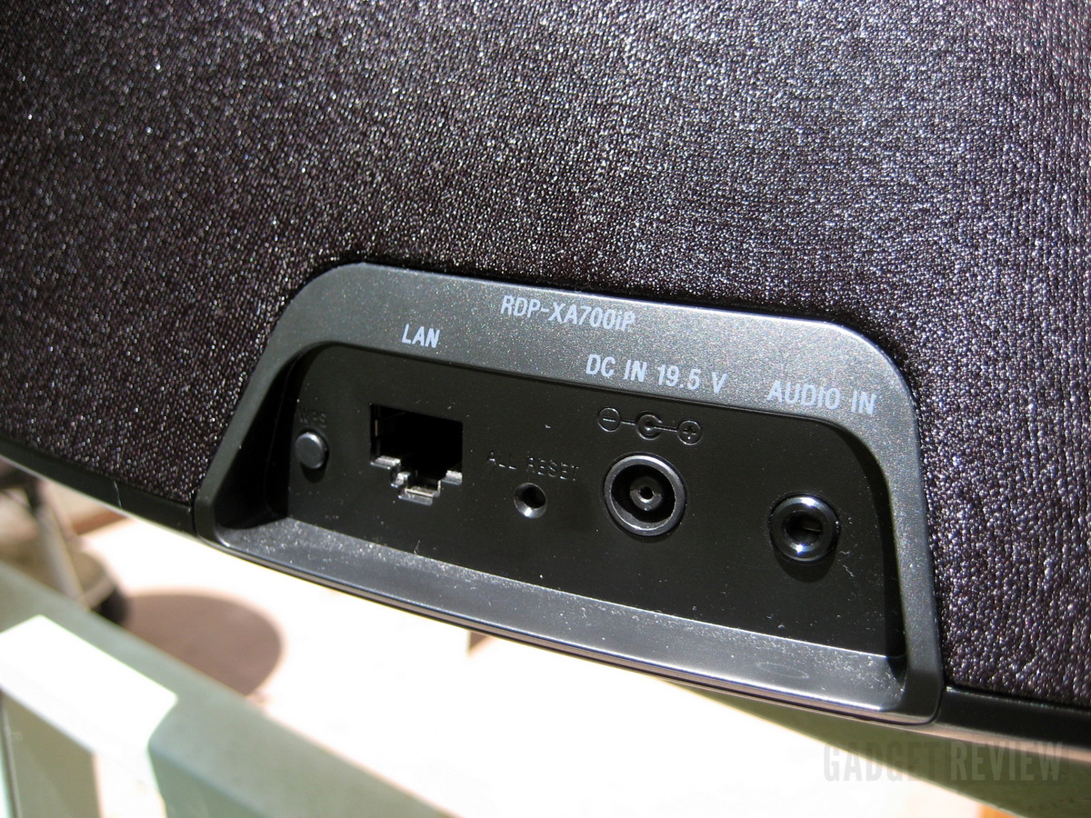

  3. Thanks for your reply.
    I did not connect them yet, what is the best suggestion to connect the external speakers to my TV :
    HDMI (arc) or Toslink splitter/converter to speakers stereo mini jack or does it harm my TV headphone-pluq to connect my speakers with the mini jack ?
    Do I need an amplifier ?
    Sending you attached pictures from my back of the TV & Speakers.
Name:	Samsung TV eu48 image.jpg
Name:	Sony SA-N310.JPG
    Regards
    Oliver
  4. Headphone Out on TV to Audio In on speakers is easiest. But you will only get stereo.
    I open my TVs up and disconnect the speakers (they are almost always use spade connectors so it's just a matter of unplugging them) and run wires to external unpowered stereo speakers.
    For example, you can get a pair of these:
    http://www.amazon.com/Polk-Audio-T15-Bookshelf-Speakers/dp/B002RJLHB8/
    for about US$50. They sound way better than speakers on any flat screen TV.

    The Sony RDP-X700IP and SA-NS310 speakers have their own volume control, so they are amplified.
    I connected the headphone out on a Samsung LCD TV to my PC speakers and it worked. I suspect the headphone out from the TV would also work for you. The speakers are probably designed so that they can be connected with mobile devices that just have a headphone jack.
