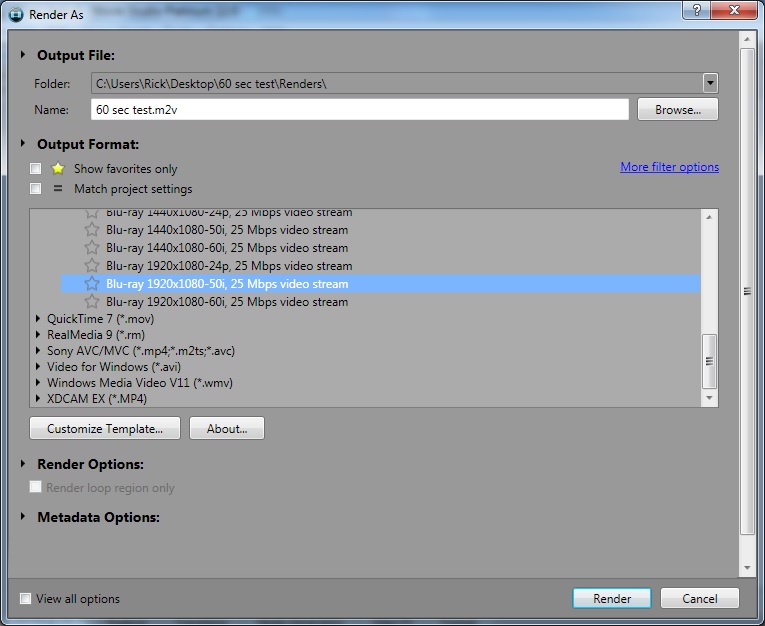

  17. Al ... Tried following the gist of what you were describing rather than exact steps .. (maybe they changed some names)
    So instead of looking for an advanced tab .. (see above post)
    I navigated through templates to Video for Windws (*.AVI)
    Selected ‘HD 1080-50i YUV
    And then clicked on ‘Customize template’ and then chose Lagarith
    Which is what I think you were intending me to get to.
    Rendered with Lagartith -
    So the 60sec file is 2.33GB ,,, following your formula
    2330/60 = 38.33 MBs
    38.33 * 8000 = 310,666 which seems an enormous figure ….. so must be misunderstanding something.

  19. Hi DB3 .... what I am trying to get to is to understand what bitrate settings I should be using in the MainConcept MPEG-2 Max/Avg/Min settings (above)
    Wouldn't actually be encoding the video with Lagarith
    I understood this step with VFW was purely to calculate the numbers for optimal quality bit rate (why we are using Lagarith Lossless )
    If I should be doing this but not with VFW then please advise.

    The default 1920 x 1080, 501 template has:
    Max rate 30,000,000 bps
    avg rate 25,000,000 bps
    min rate 20,000,000 bps
    I could of course leave at that ...... just trying to find out if optimum for limited motion slide show ............ I know you advocate .. play & see, just thought there may be a quicker route to get to the figures.

    Forget about MediaInfo, calculate it or use Bitrate Viewer for this sort of things.
    DB83 - for Christ sake , we are trying to get proper and lowest bitare for his video, that was his original question, he is almost there, of course he will use his Vegas to render his Blu-Ray stream there.
