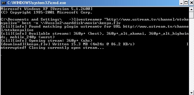

  2. just stream it with livestreamer to vu+ box /hdd
    and watch it as it streams from there
    change Vusolo2 to whatever is named in
    /etc/hostname
    livestreamer "http://www.ustream.tv/channel/ntvkenyalive" best -o \\Vusolo2\harddisk\movie\kenya.flv
