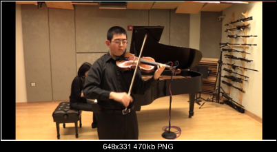

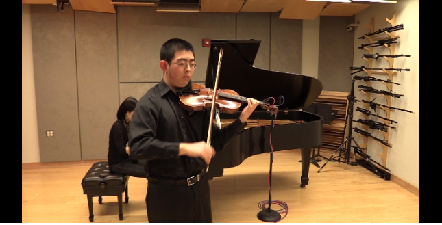

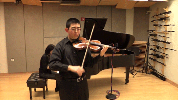

    Here are the two frames that I was talking about:
ID:	34279Click image for larger version

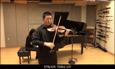

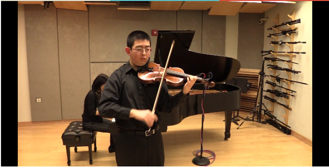

  5. A crossfade between the two clips probably wouldn't look too bad. Or you could try using motion interpolation techniques. This is three interpolated frames between your two images, and then reversed:
    You would really want to cut the first clip a few frames shorter, and the second clip a few frames later, then replace the missing frame with motion interpolated frames -- so the total number of frames is the same and the audio will match.
