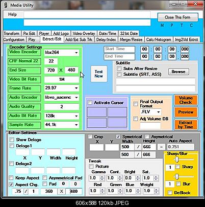

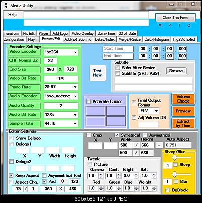

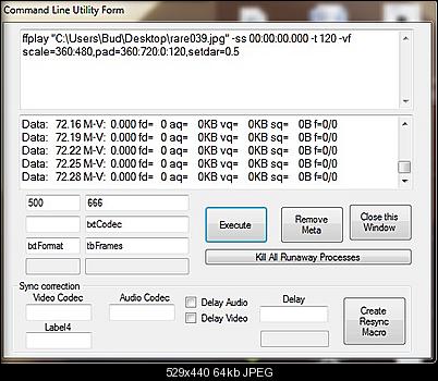

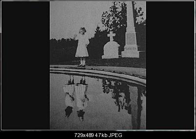

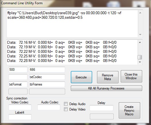

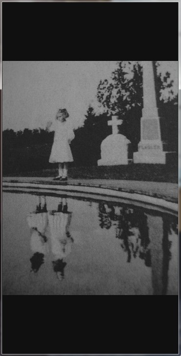

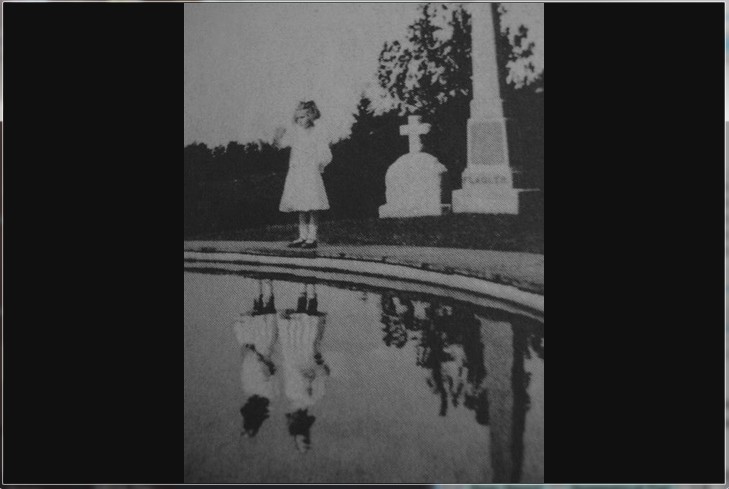

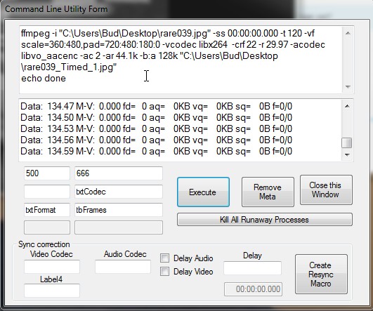

    An alternative is FFMpeg, since you must re=encode anyway, and use the pad filter setting the size to a common one that would take care of the divisible by 4,8,16 mentioned earlier:
Name:	ScreenHunter_173 Oct. 31 22.33.jpg
ID:	34286Click image for larger version
Name:	ScreenHunter_173 Oct. 31 22.41.jpg
ID:	34287Click image for larger version
Name:	ScreenHunter_173 Oct. 31 22.35.jpg

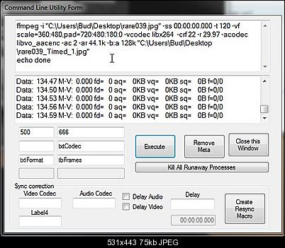

    or use the alternative bars as:
Name:	ScreenHunter_173 Oct. 31 22.48.jpg
ID:	34289Click image for larger version
Name:	ScreenHunter_173 Oct. 31 22.51.jpg
ID:	34290Click image for larger version
Name:	ScreenHunter_173 Oct. 31 22.49.jpg

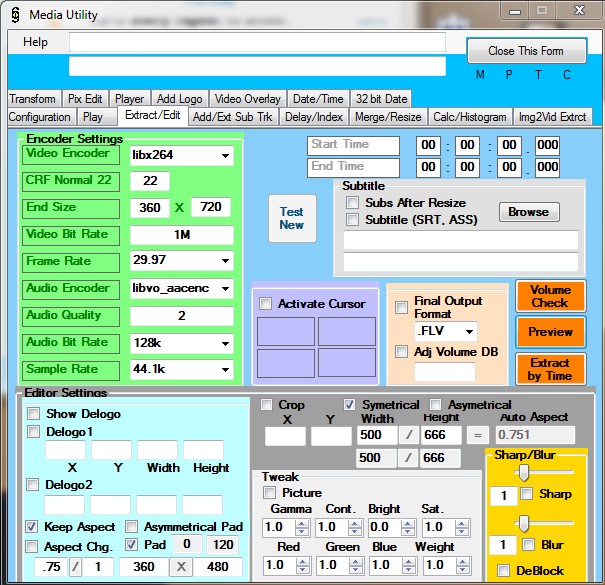

  5. Originally Posted by Budman1 View Post
    [Attachment 34286 - Click to enlarge]
    [Attachment 34287 - Click to enlarge]
    [Attachment 34288 - Click to enlarge]
    [Attachment 34289 - Click to enlarge]
    [Attachment 34290 - Click to enlarge]
    [Attachment 34291 - Click to enlarge]

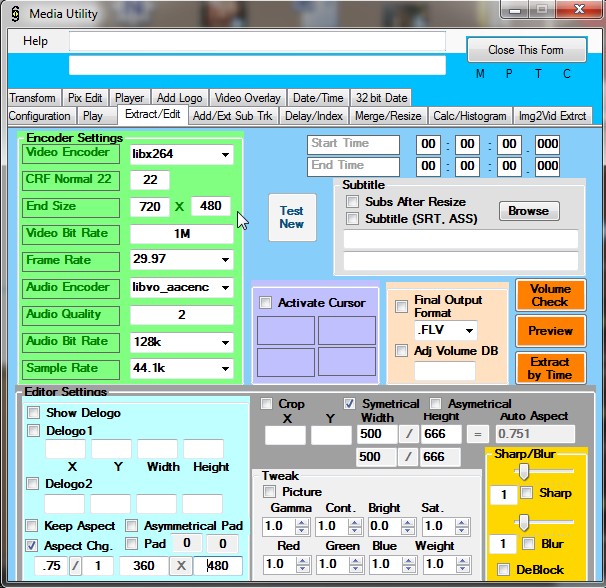

    Which Tool are you use in this screenshots ?

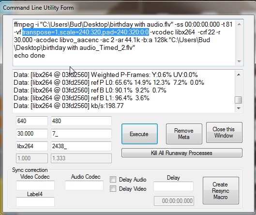

  6. Any idea to rotate a video 90 degree right ?
  7. Member Budman1's Avatar
    Jul 2012
    NORTHWEST ILLINOIS, USA
    The program is something I wrote that does most of what people ask for instructions on. I use it to create the script without taxing my memory and verify it works. Then I post the images for people who are not familiar with FFMpeg or AVIsynth so they can match the script parts to the labeled image. It was designed to stop with the scripts or avisynths saved as files for people to check if they need to learn or change if they already know them.
    Rotating for 90, 180,270 is easily done with the transpose/hflip/vflip:
    -vf transpose=1 (rotate 90)
    -vf transpose=2 (rotate 270)
    -vf vflip,hflip (rotate 180)

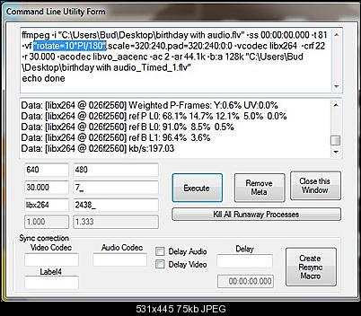

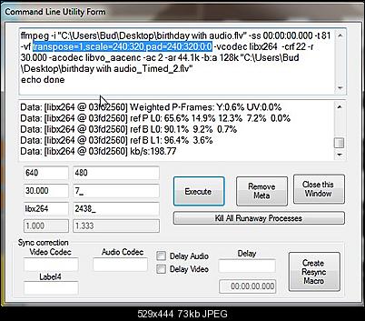

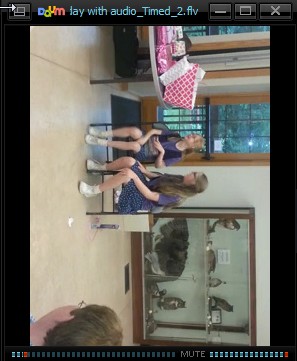

    Name:  ScreenHunter_174 Nov. 01 12.56.jpg
Size:  29.1 KBClick image for larger version
Name:	ScreenHunter_173 Nov. 01 12.52.jpg

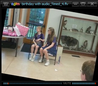

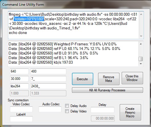

    Or if you want by degrees, the later ffmpegs have "rotate" added as a -vf filter. Plus degrees for clockwise and - degrees (-vf "rotate=-10*PI/180") for counterclockwise. Be sure to use CAPITAL letters for the PI/180
    Name:  ScreenHunter_175 Nov. 01 13.00.jpg
Name:	ScreenHunter_174 Nov. 01 13.00.jpg

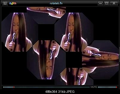

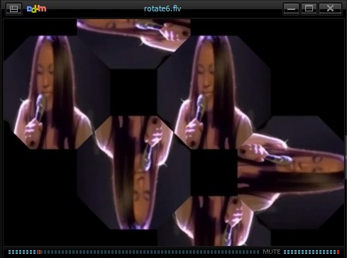

    You can also use avisynth and get creative:
    v1 = DirectShowSource("C:\Users\Bud\Desktop\untitled.rm").converttoyv12.lanczosresize(160,160).Rotate(-45)
    v2 = v1.TurnLeft()
    v3 = v1.TurnRight()
    v4 = v3.TurnRight()
    v5 = v3.TurnLeft()
    v6 = v3.turnRight()
    StackVertical(StackHorizontal(v2,v1,v3),  StackHorizontal(v5,v4,v6))
    Rotate(45)
Name:	ScreenHunter_175 Nov. 01 13.08.jpg
