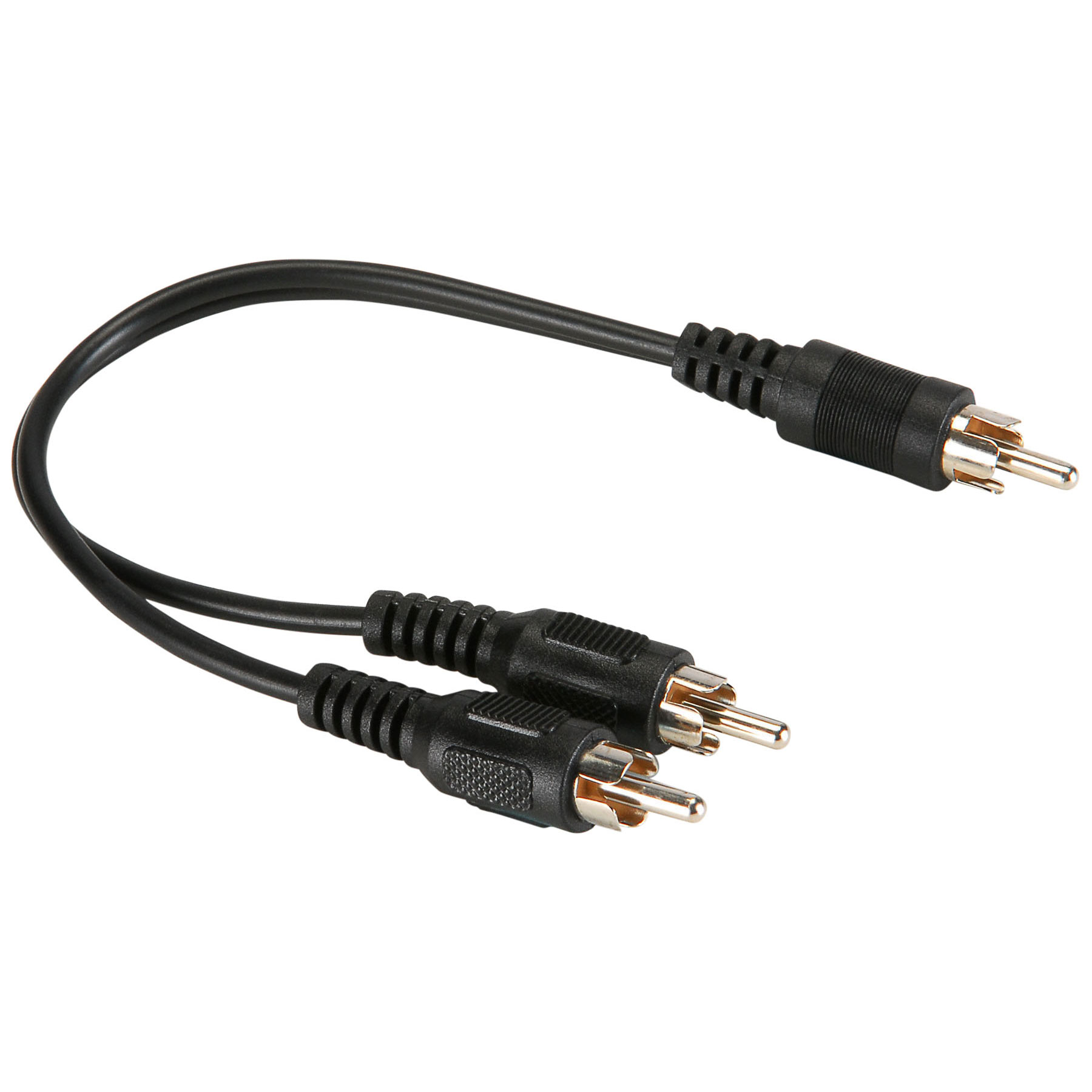

    This "new" VCR I bought ($8 at Goodwill) has a mono output. So, I get nothing on the right side of my speaker set.
    Can I use an RCA splitter to fill up both the right and left channels? It's not real stereo, but it would be less annoying, right?

    Yes it will 'centre' the sound for you. Ideally you would pass the mono signal through a splitting amp or resistive network that provides two outputs but what you suggest should work OK. Try it and see....

    Simple Y-cable should do the same thing, probably for less cost. Slight impedance mismatch, but never really noticeable. Has worked for decades.

  6. Do what Cornucopia wrote, all you need is a Y.

    Yes, I have two little zip-lock bags full of the two forms of RCA Y-adapter. That's not the problem, now. While good enough for the tapes we recorded with our old VHS camcorder, you can hear the difference on commercial tapes, and I have a box of those to archive.
