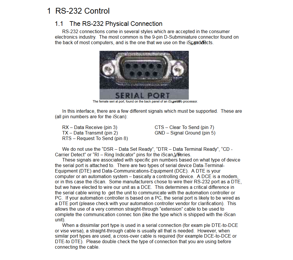

    The VPxx Serial port is a DCE. This means that the VPxx acts as a modem and thanks to a documentation I found on the web, I was able to figure out that the VPxx serial input uses the following RS 232 signals (pins) in order to cummunicate with devices like terminals and/or computers for automation and updates :
    - RX
    - TX
    - RTS
    - CTS
    - GND
    This means that five pins needs to be soldered to make a complete connexion of the VPxx serial port (DCE) and my computer (DTE). My cable only have 3 pins connected bewteen the two ends! It might also explain why Tera Term couldnt send the right input to the DVDO to launche the update sequence through the Bootloader.

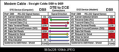

    What I need now is a full diagram of the original serial cable that DVDO provides with the VPxx series in order to build this cable (can't find my original one).
    I found some infos here and there but if someone could confirm a working diagram for a DB9 (M) > DB9 (F) (DTE - DCE STRAIGHT THROUGH CABLE)
    Or if someone PLEASE provide me a diagram of the serial cable that he/her used on the VP to complete the updates? Any info about that is welcomed !!!

  4. "Straight-thru" cable always meant "all pins wired" to me. Generally better-quality cables are this way, been a VERY long time since I needed one. Try Newegg.
  5. Originally Posted by Nelson37 View Post
    Yes, It's old and really not used by everyone !
    Well the best option would be to connect all 9 pins for sure. That way your cable is able to do pretty much everything (as a straight-thru of course). Some cables called "Straight-thru" arent always 9 pin connected. Some are 4 other 5 etc .. basically you just need to know what your hardware needs (aka what pins it uses) to communicate with a terminal or a computer or whatever...
    I think the VP needs RX TX CTS RTS and GND (according to the document above) My cable was only covering RX TX and GND.
    Will solder that cable and post results soon.

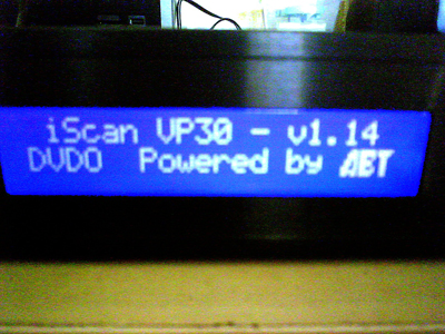

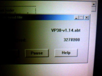

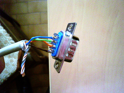

  6. I finally build the cable and linked RX/TX/CTS/RTS and GND together.
    The operation is a 100 % success!
    I'm kind of proud right now because even the DVDO support couldnt bring me a correct answer.. It felt like I was talking japanese to them when I mentionned specific pins of a db9.. anyway it worked.
    So if anyone is having a freeze during the VPxx update, it might be his cable!

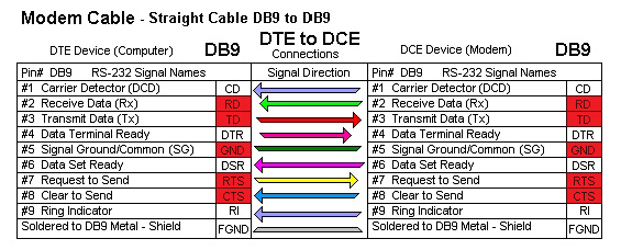

    All he got to do is to solder the following pins:
Name:	ISCAN SERIAL DIAGRAM.jpg
    works like a charm !
