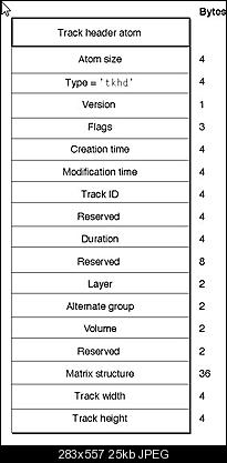

    Normally the Height and width for a 'Standard' MP4 container are stored as the last 8 bytes of the atom TKHD. Use a hex editor such as HxD and search for TKHD. If you don't find it then X265 is storing different than x264 like an MPEG4-TS file. Windows probably can;t see it's normal location for information
Name:	ScreenHunter_173 Oct. 25 14.20.jpg
