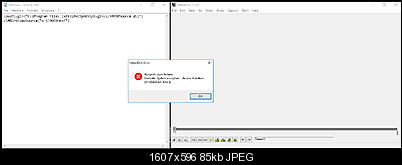

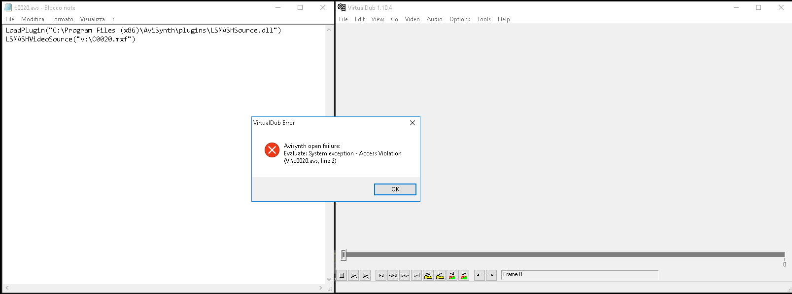

    I have installed avisynth 2.6.0 and lsmash R729 with libav (L-SMASH-Works-r729-20141117-32bit-Libav.7Z)
    but crash:

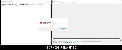

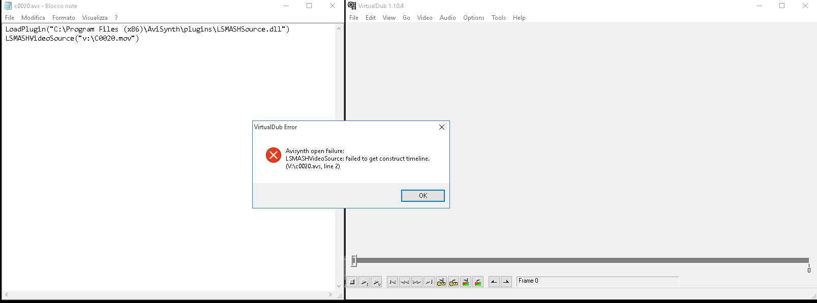

    but if I convert the .mxf in .mov
    ffmpeg -i C0020.MXF -vcodec copy -an C0020.mov
    and try to open the .mov this error happen:

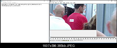

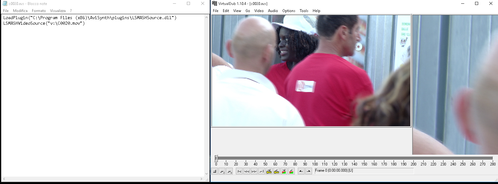

    so I try to replace the LSMASHSource.dll with another version (I don remeber is is a older version or not)
    I have try with this:
    https://www.dropbox.com/s/zc2sri25g3qtkz8/LSMASHSource.dll?dl=0
    (I have put it on the avisynth/plugins directory)
    and opening the .mov is OK

  5. LWLibavVideoSource("C0020.MXF")
    (LSMASHVideoSource is for MOV, MP4 derivatives)
