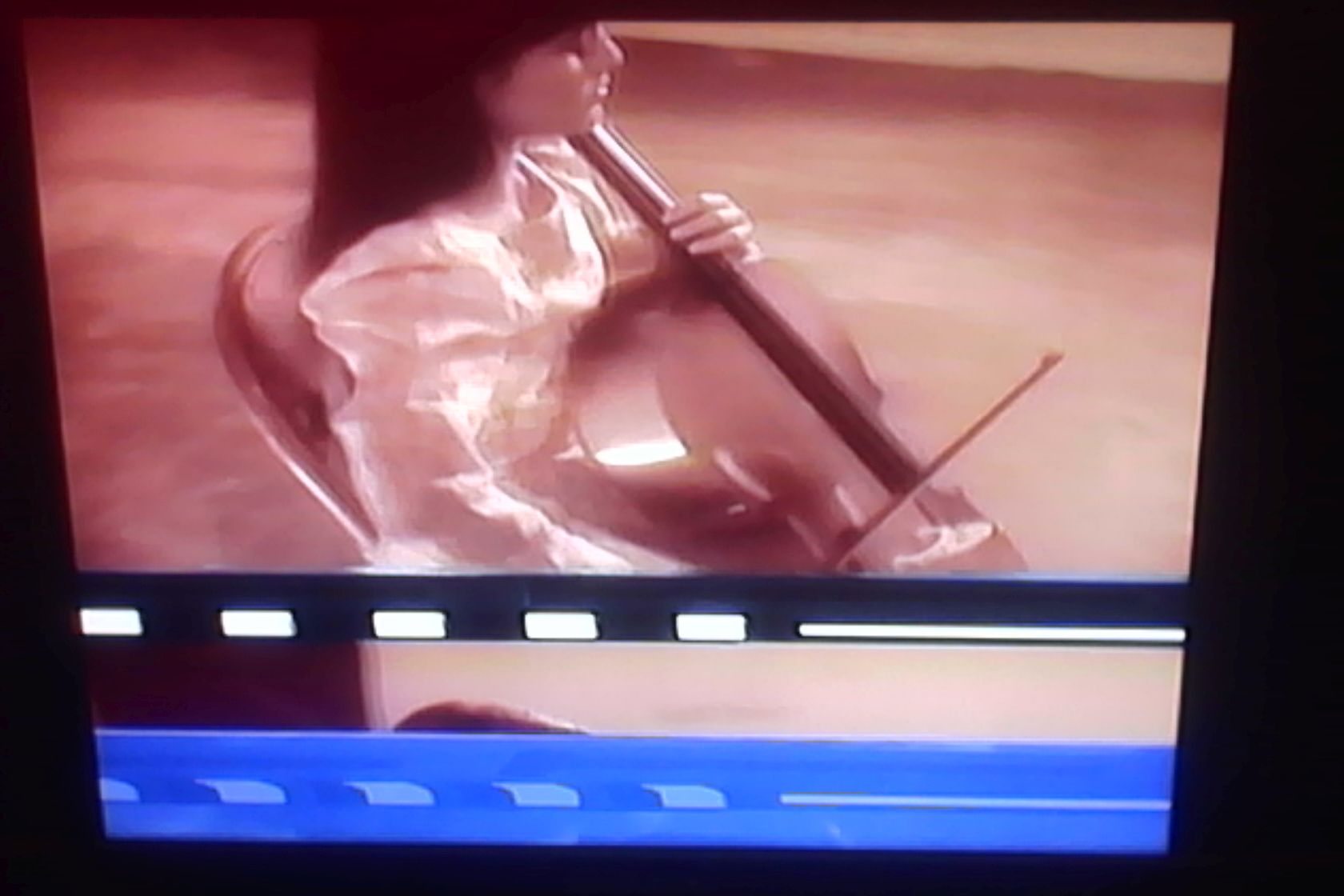

  1. I am trying to copy my VCR tapes to a DVD recorder, mostly are home recordings but a few tapes from the store I suspect are copy protected. Is this a sign of copy protection ? (This image was captured using mobile phone)

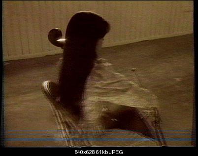

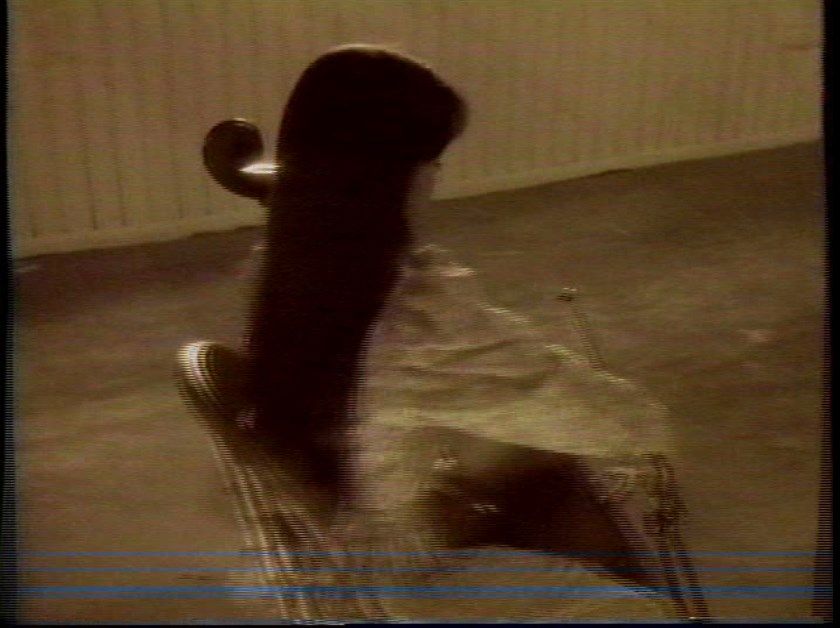

    Unfortunately the video flickers horribly. It's not so obvious in this static image, but in the video it's like waving vertically (left-right) continuously. I also get blue screens in between frames as if the video signal was too weak (this is worse in the home recordings).
    This flickering happens with BOTH home recordings (which I had no problem copying with the DVD-R) and copy-protected ones (although it seems to have removed the copy protection). However, the video captured when the source is from a DVD player is ok. Am I missing something or is the device unable to handle VCR signals? I have tried changing the settings in the software provided (Arcsoft Total Media).
    I have also tried other routes:
    VCR -> TV IN -> video out-> usb device - flickering
    VCR RF OUT -> TV RF IN or DVD RF IN -> video out -> usb device - no flickering but copy protection

  6. I didn't have time to do more tests, but to clarify...
    VCR RF OUT -> TV RF IN or DVD RF IN -> video out -> usb device - no flickering in both cases, but affected by copy protection
    Similarly, for VCR video out -> DVD video out -> TV (haven't tried this with usb device in place of TV - but I guess it should be the same)
    But now this looks strange: VCR -> TV IN -> video out-> usb device - flickering .... either my mistake or the TV video out is as bad as the VCR out (unless I use TV RF IN).
    And the cables, I did try a few.... can't be all bad.
    I quite agree with your last conclusion, seems like that the signal coming out of the VCR is not good / strong enough for the USB device.

    Noise in the signal can sometimes have the same effect as Macrovision and CGMSA.
  9. "VCR RF OUT —> TV RF IN or DVD RF IN —> video out —> usb device - no flickering in both cases, but affected by copy protection"
    Oh, what I was really trying to say is.... no flickering in both home-made and store tape, but the store tape showed the copy protection signal (that black-white bar in the first image attached). ----> case A
    The other case being flickering in both home-made and store tape, but in the store tape the copy protection signal is gone (it looks good except for the flickering) ---> case B (e.g. VCR -> usb device)
    And the best case which I am trying to achieve, case C - no flickering, no copy protection signal (e.g. watching the video on TV: VCR-> TV IN)
    So for all the various combinations that I have mentioned, the result is A, B or C.
    I will try more and other tapes when I have the time.
    Although I am tempted to just park a digital camera in front of my TV screen to record it !

  11. Member n8tvm's Avatar
    May 2002
    West Virginia, USA
    From the top image you can see the white blocks in the vertical blanking interval (the black bar) that is macrovision (a copy protection used on a lot of VHS tapes). there used to be devices to remove it or some capture devices don't care and are not sensitive to it.
