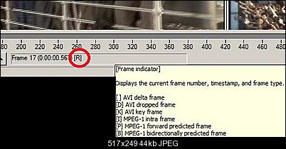

    In this still from VirtualDub, 'R' (repeat?) frames are indicated - but the information tag doesn't define them.
    Is this a Virtualdub 'heads-up' ?
    AviDemux indexes the file and doesn't show them.
    The creator has completely shut down the old site so no searching there.

    There is also [M] as 'Masked Frame'
    Do you have any plug-ins installed that could possibly alter this ? My take on [R] = 'Reference'

    VirtualDub doesn't open mpeg2 without a plugin, so I suppose it's possible.

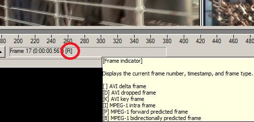

    Here's a few frames.

    VdubMod does.

    Yes , tried that, it removes pulldown frames without asking - not that I'm complaining?
