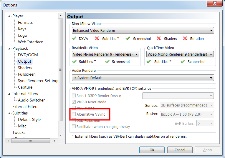

  6. Originally Posted by DBenz View Post
    Also on that part of the dialog there is an Alternative VSync option. Try that. Or if it's already enabled disable it.
    I cant find this, just where is it ?
