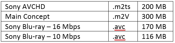

    The source is a video form Sony Vegas of a a family 35mm slide collection ........... so movement not much more than simple slide pan & zoom animation with a stereo audio track.
    I know that as I want a European disc for HD wide screen TV .. then it's 1920 x 1080 50i which gives me 25fps
    The confusion I have is that I can render video to several options under 'Blu-Ray' output
    Sony AVCHD 1920 x 1080, 50i which gives me .m2ts files
    Main Concept Blu-ray 1920 x 1080, 50i which gives me .m2v files
    Sony Blu-ray 1920 x 1080, 50i which gives me .avc files
    The latter I can select as 10 or 16Mbps video stream
    The table below gives indication of different file size for a 1:38 sec sample (12 slides)
Name:	File sizes.jpg
    Which file format (codec type) is the correct or most suitable for a compliant Blu-Ray DVD.
    If the .avc is no problem (assumed) then is there any reason to use 16Mbps over 10 Mbps ?
    Initailly I thought I had a bigger problem none of my usual players could play .avc files ....... Splash lite, VLC, 4K, (which is listed as suitable) but dropped back to MPC-HC and that worked OK .... don't know if that means .avc is a lesser option or not.

    I would choose m2ts.
    But a blu-ray is not just a single file. It's a BDMV folder with several files, https://www.videohelp.com/hd#filestruct . But the video is in m2ts.

    As above, you still have to author your file(s) into a compliant format and then burn those files to disk.
    .avc = advanced video codec = h264. If the video has .avc as the extension ie myvideo.avc a player might baulk. But wrap that avc into a container format such as .mp4 and it will play.
    BTW Shocking waste of bitrate for essentially still images. But, obviously, you have motion for the transitions.
