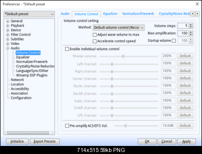

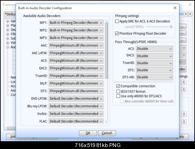

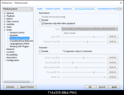

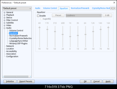

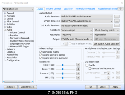

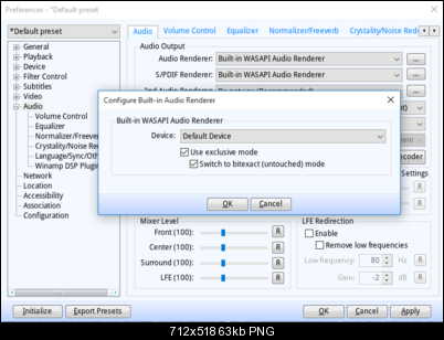

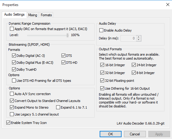

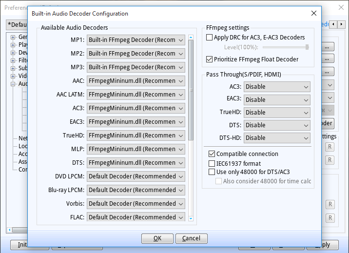

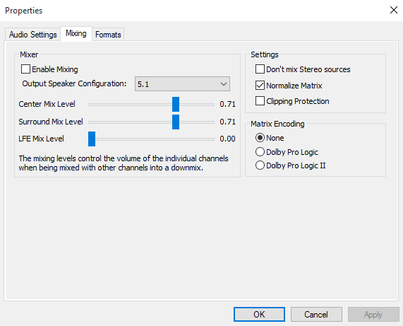

  1. Hello everyone,
    I own the Samsung HT-J7750W (http://www.samsung.com/uk/consumer/tv-audio-video/audio-video/home-theatre-systems/HT-J7750W/XU), and I am trying to get the best sound quality possible via Potplayer & LAV filters. I have Reclock installed as well - I am using the "LAV Filters Megamix".
    The graphics card is connected via HDMI to the TV, and the receiver to the TV ARC port - the blu-ray and TV work as intended. However, in Potplayer, the rear speakers do not produce sound unless I have "Virtual Surround" or "DTS NEO FUSION II" on in the receiver - and although the sound is clear, sound direction seems completely broken.
    Here is the configuration:

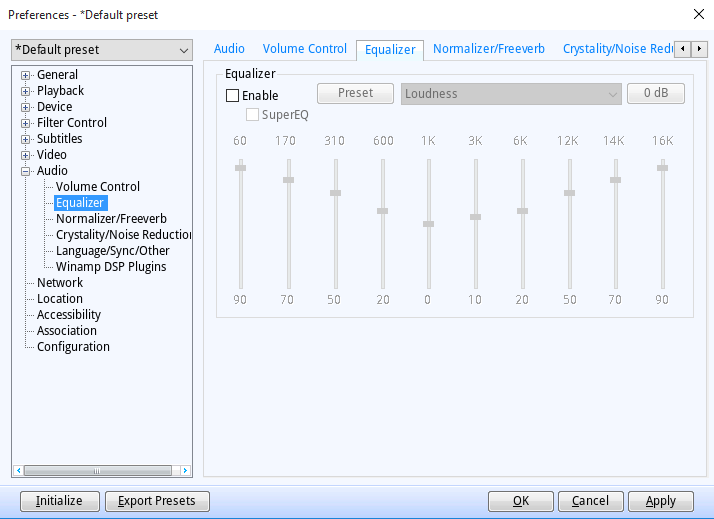

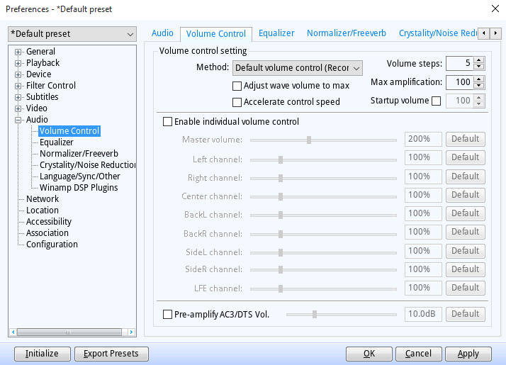

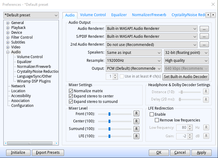

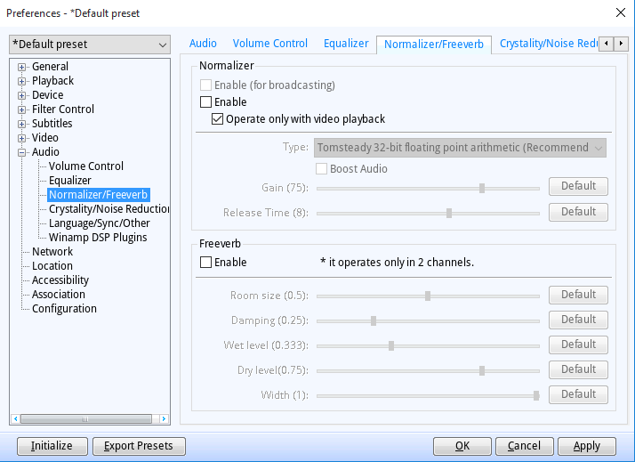

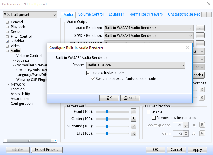

    Potplayer settings:
    1:
    2:
    3:
    4:
    5:
    6:

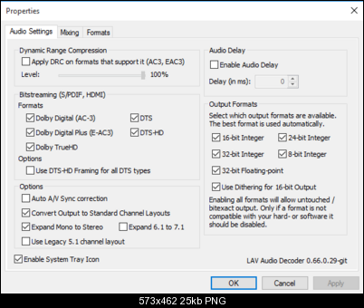

    LAV Filters:
    1:
    2:
    Any suggestions are welcome, please excuse my ignorance, these settings are the result of a lot of research, but my setup skills are inadequate.
    Have you tried pass through(SPDIF/HDMI) the audio?
  3. I thought that selecting "WASAPI" & "bitexact (untouched) mode" along with the Bitstreaming options on LAV achieve this? If not, what do I have to change?
