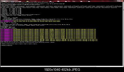

    Here a screenshot after merging with the batch:

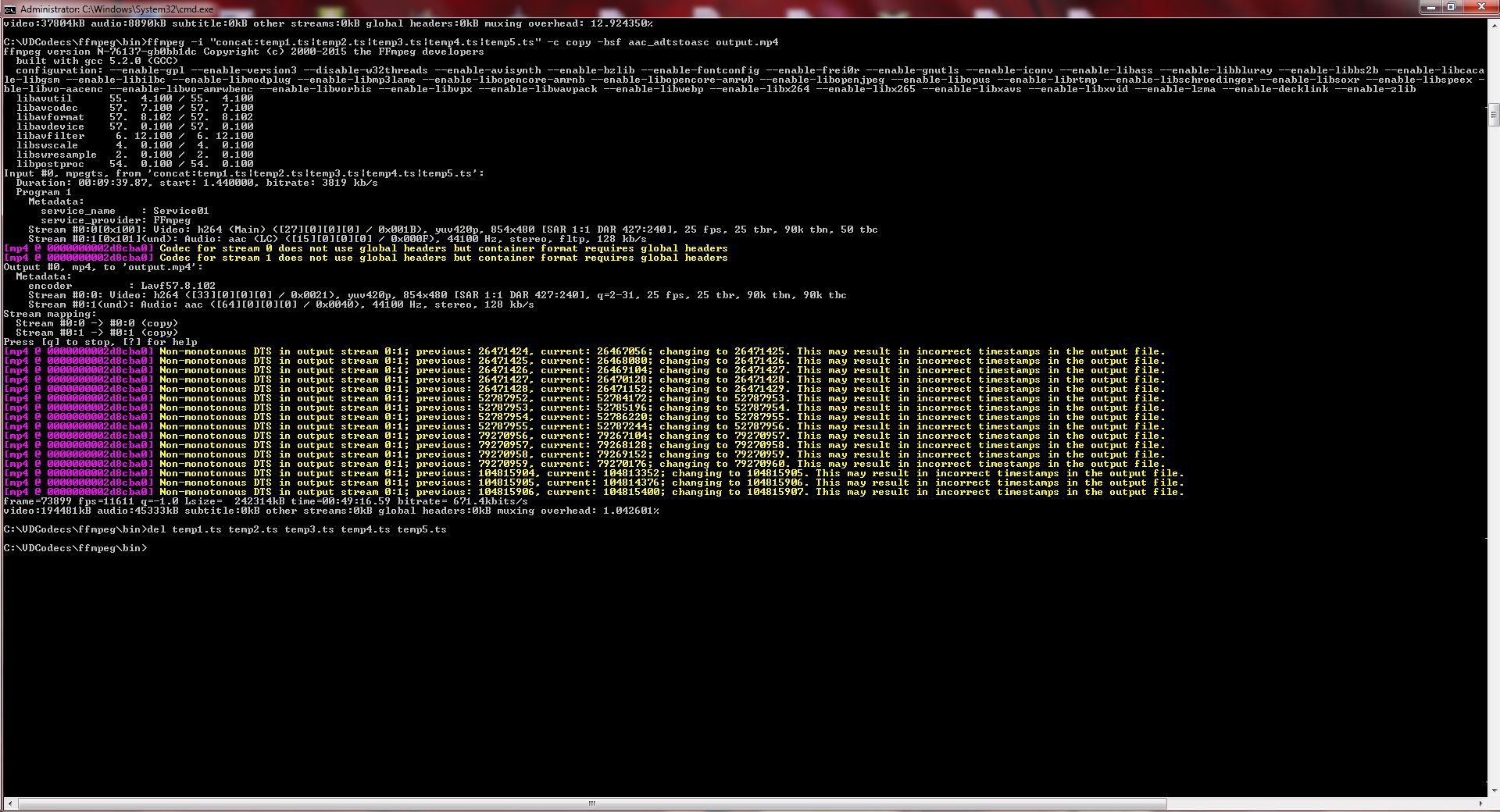

    When editing the videos, I get much more of these yellow entries, the above shot is just an example without editing. The 2 first yellow lines are always present, the remaining ones point to a possible "mismatch in the timestamp".
    As said, the output is fully playable with no glitches in my video players or else.
    What are the possible consequences of these "mismatches" and should I correct these, and if yes how? Or can I just ignore them?

    Your problem is that MPEG Transport Streams (and also Program Streams) don't have index chunks pointing to GOP starts (MP4 does have that), thus need a continuous timecode next to the video stream to aid random seeking. If you convert 5 parts one after another, each of them will probably start with a zero timestamp (if not defined otherwise); combining them will cause the timecode get reset at each joint. To avoid that, you would have to convert the 5 original MP4 parts as a logically continuous input. Or you may have to get the timestamps in the concatenated output rewritten to be continuous now.
    There are some related ffmpeg options:
    -copyts             copy timestamps
    -start_at_zero      shift input timestamps to start at 0 when using copyts
    -copytb mode        copy input stream time base when stream copying
    Unfortunately I don't know which to use when in your case.
