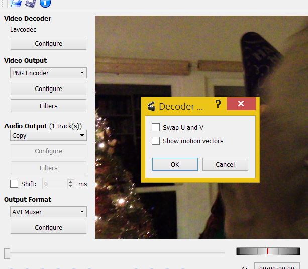

    I chose 3 different encoders, then clicked 'configure' - still no luck. I'm attaching an image - what do I do now?

    I re-downloaded Avidemux (2-6 - 64 bits); I set the codec at h264 (ffinvidia); adjusted the filter; checked 'play filtered': and it played as I had set it - lightened.
    However, as I tried to save it, I got the message 'cannot set up codec - Bit rate too low?' - I use VLC for videos - would the bit rate apply to the video and/or VLC? If so, can I fix that?

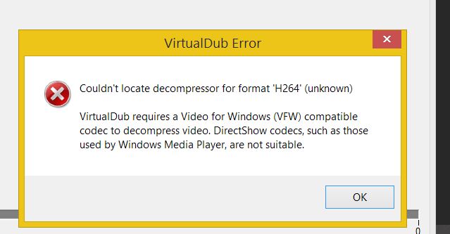

    Virtualdub (which I used with my old computer, Windows XP) won't let me download my files if they are not original .avi files (I'm attaching their message). I assume that's also a question of using the right codec? Most of my original files were .mov, and I convert them to .avi as needed.

    Right: like Theewizard advises — and reminds * –, beginners (and not only...) often stumble on:

    Note 1 · Although "VirtualDub" ("VD") does not manage ".aac" audio (or via a special ".aac" plug-in, but there is a simpler solution), ".mp4" files containing AVC H.264 video + .aac audio open in "VD" once you add the "VirtualDub-FFMpeg-Input-Plugin". See below.
    When converting, "VD" will save your video to: the ".avi" container, and include audio under ".wav" format (within the ".avi").
    [ Or ".mp3", but limited to lousy low bitrates only (under Win. XP anyway, unless installing "ACM"...); in almost all cases, avoid ".mp3" at low bitrates! ]
    Note 2 · "VD" can encode to "x264" AVC H.264, once you install the freeware (lightweight) "x264" "VfW · Video for Windows" version exclusively — if you want to recode to AVC H.264 using "VD".

    Next, when "VirtualDub" refuses to open something you drop to his face, instead, click: File > Open video file (or Ctrl+O) and, at bottom of "Open video file window", select (at File types field):
    "FFMpeg Supported Files", before clicking your problematic video. It sure helps in many cases! When it works, it may sometimes slow down the ("VD" cursor) scrolling of your video display but, if you mainly need to recode, you might survive...

    When you type "download video to VD (VirtualDub)", I assume that you simply mean "OPEN in VD" (otherwise, you just added a new option to "VD" : video downloading ! ).
    And: YES, the typical "Couldn't locate decompressor..." "VD" warning OF COURSE means that the needed coDEC ("dec" = decompressor) is missing.
    Little reminder #2, here: the "MediaInfo" freeware displays the name of the codec that created a video, that you drop to its interface.
    Don't forget that, as opposed to "AviDemux", "VLC" + some others, "VD" is not autonomous. It relies on the codecs that are (already) installed in your version of Windows and, when they aren't, on the codecs that YOU install in Windows.
