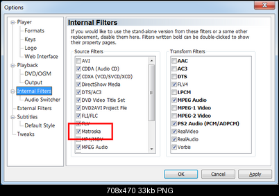

  4. Enable the Matroska source filter in MPC.

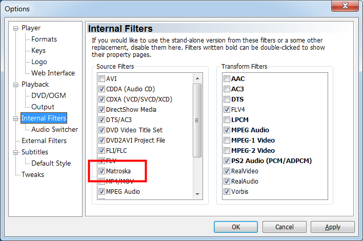

    I didn't see a setting from Matroska in my MPC settings. Here is a screenshot of my settings:
  6. Originally Posted by darklight1138 View Post
    That's odd. I have old versions of MPC and recent versions of MPCHC and they all have Matroska source filters. Exactly what version are you using? 32 bit or 64 bit?
    Also, disable MPC(HC)'s internal h.264 decoder to use an external decoder.
