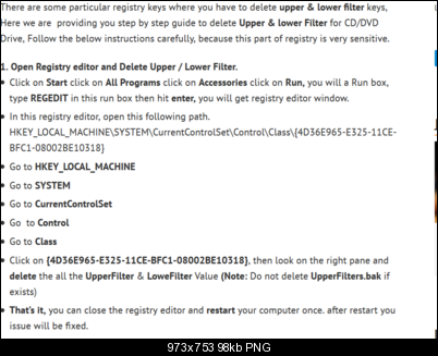

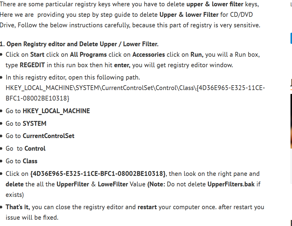

    Use the snipping tool to make a png image of the site. Or do a Google search for "remove upper and lower filters" and you'll see a dozen such write-ups. You, of course, don't want to remove all the filters, just the DVDFab Passkey filter.
    Or just look at this image of the instructions:
Name:	removing upper and lower filters.PNG

  20. An update for anyone still following this.
    The procedure given didn't work.
    After reboot the same error message appears and within the directory
    there was _now_ ControlSet 001
    Control Set 002
    and Control Set (plain)
    I did not see upper and lower filters .bak. I have experience editing the registry
    A listing called Properties is there but cannot be tampered with and I did not try.
    There's a big something left to do about which I have no idea.
