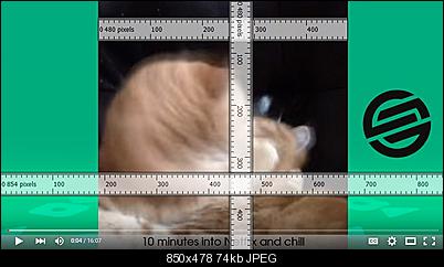

    I registered because I see very interesting and want to learn video editing but for now some things but my intention is to learn more.
    I need help with this :

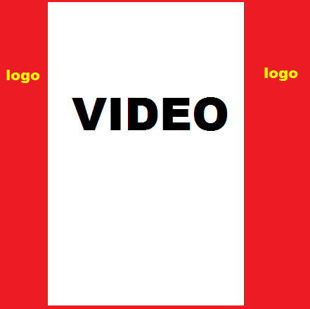

    1. How i can edit multiples videos at once?, i want to put frame to 100 videos for example:
Name:	Sin tÃ*tulo.png
    All day I've been investigating but have not found much, I found useful is the program VirtualDubMod but i dont know how start and program .

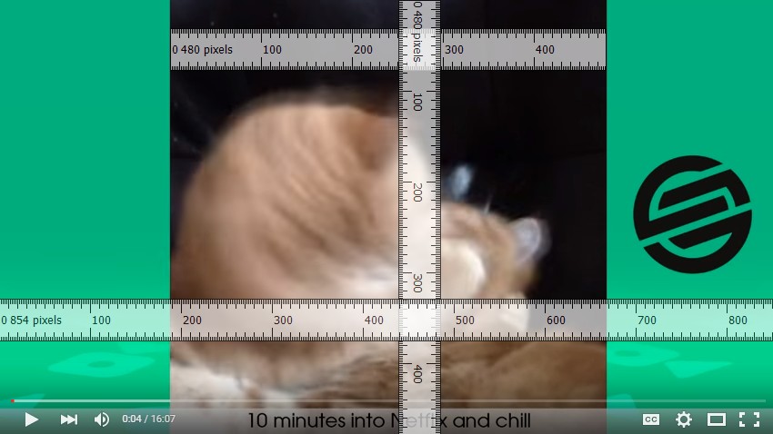

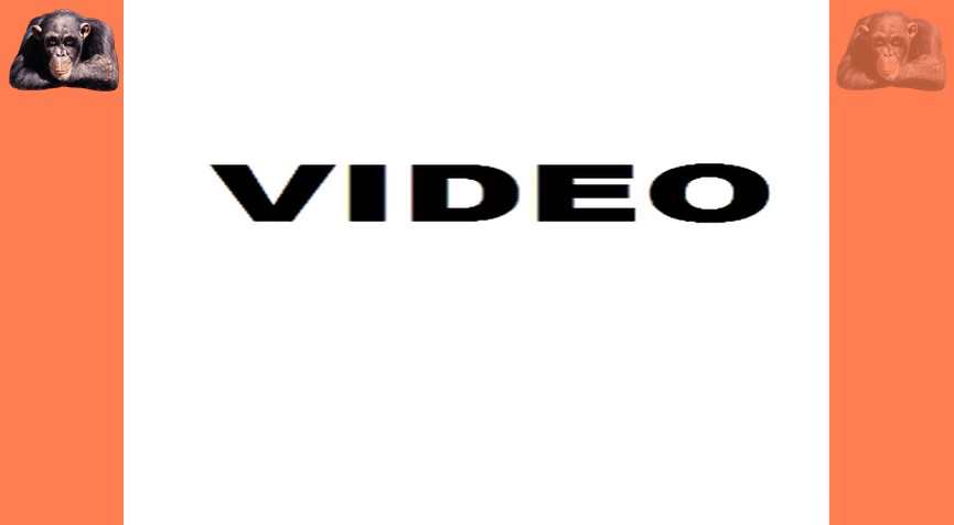

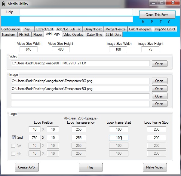

    Also assuming you just want to add non-intrusive logos on a 640x480 video to achieve 16/9 854x480 as suggested by Cornucopia.. A head start on the ffmpeg, Avisynth scripting would be to use like:
    v2 = Directshowsource("C:\Users\Bud\Desktop\image001_IMG2VID_2.FLV").ConvertToRGB.Lanczosresize(640,480)
    v1 = AddBorders(v2, 114, 0, 114, 0 , $FF7F50)
    img1 = ImageSource("C:\Users\Bud\Desktop\imagefolder\TransparentBG.png",  pixel_type="RGB32", fps=25.000, end=200).fadeio(28).converttoRGB32.LanczosResize(100,75)
    img2 = ImageSource("C:\Users\Bud\Desktop\imagefolder\TransparentBG.png",  pixel_type="RGB32", fps=25.000, end=200).fadeio(28).converttoRGB32.LanczosResize(100,75)
    clip1 = v1.trim(0, -100) + v1.trim(100, -200).Overlay(img1, 10, 10, img1.ShowAlpha()).Overlay(img2, 760, 10, opacity = 0.3, img2.ShowAlpha())+ v1.trim(300, -300)
    Return clip1

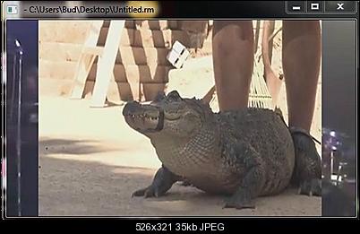

    Then use this as your input to ffmpeg and your should get something like below. I have added images to show what the numbers mean and you should notice that the transparency of the right image is less due to the opacity=0.3 entry above. Use it or not as needed.

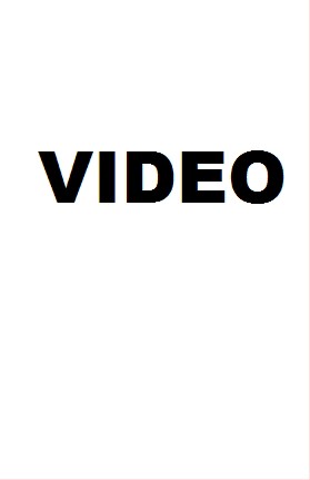

    Original video:

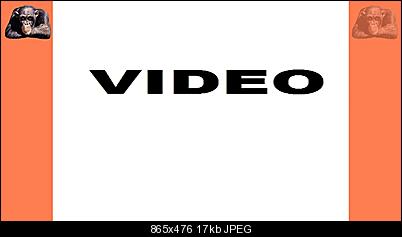

    Result:
Name:	ScreenHunter_169 Oct. 15 00.32.jpg

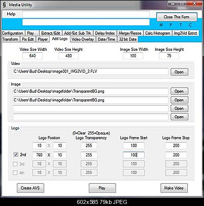

    Assist image:
Name:	ScreenHunter_169 Oct. 15 00.29.jpg

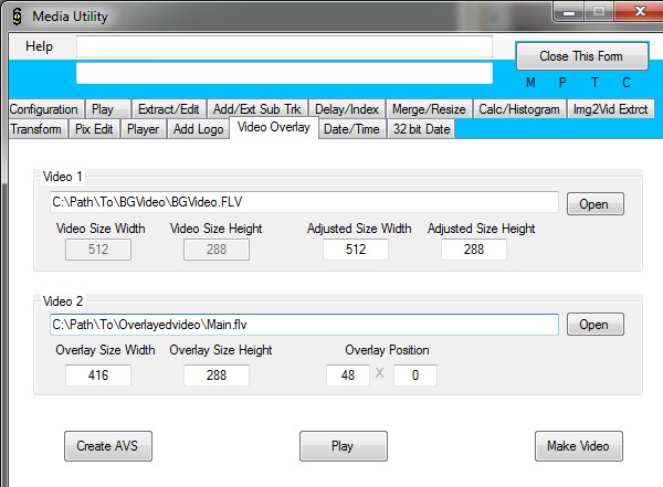

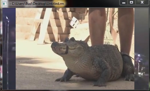

    Viviana, Your example is a semi-transparent background with a logo and your original video overlayed on it to make a 16 x 9 (854 x480) final video from an original 480x480 video. I'm posting a method here since Private messages seem not to want to let me upload images??
Name:	ScreenHunter_169 Oct. 16 22.37.jpg

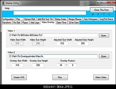

    This can all be done with FFmpeg if you have the background image with Logo. First convert the BG image to a video long enough to cover your original video duration. Then overlay the video on your background:
Name:	ScreenHunter_169 Oct. 16 22.48.jpg
    with code such as:
    ffmpeg -i "C:\Path\To\BGVideo\BGVideo.FLV" -vf "movie='C\:\\Path\\To\\Overlayedvideo\\Main.flv'",scale=416:288[video1];[in][video1]overlay=48:0,scale=512:288 -crf 20 -q:v 2 "C:\Path\To\OutputVideo\IMG2VID_1_OVRLY_2.FLV"
    Which corresponds to:
Name:	ScreenHunter_169 Oct. 17 00.34.jpg
    If you are going to use the same background video for all, this is not too bad a method but if you are going to use different ones, this will be time consuming and you may want to go with the added borders (solid color) and the Log which can change.
