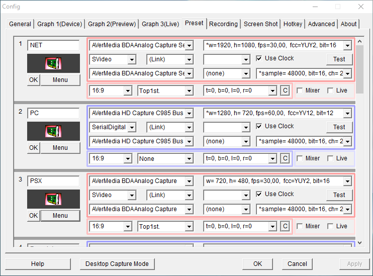

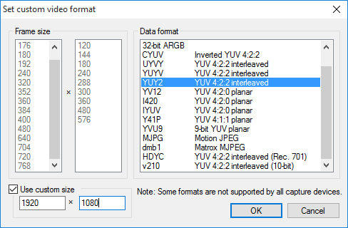

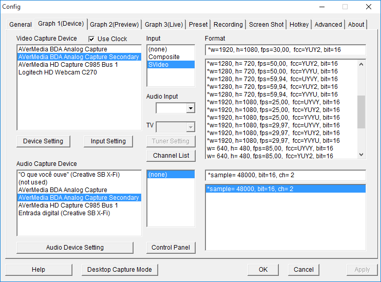

    Apr 2007
    Virtualdub is interesting. It's not recognizing an HDMI source but only SVideo or Composite.
    The device is "Avermedia BDA Analog Capture Secondary (Direct Show)" and the Format only goes to 720x480.
    I did find the setting for framerate, but now i can't find the setting for bitrate.
    I tried a brief capture, which went at 143mbs! Much too high and it was at 720x480, in an AVI it seems
    how to make it recognize 720p and set the bitrate to something lower or is that not possible?

  17. Lone soldier Cauptain's Avatar
    Jan 2006
    Brazil
    Yes, Avermedia never fix this. HDMI input is "S-Video".
    Using UT VIDEO 422 BT 601 - ULY2, only select OPTMIZE FOR COMPREESION. No way to set bitrate using lossless codec.
    The only codec is X264VFW. But its will lag in some computers and the compatibility is poor on AVI container.

  30. Lone soldier Cauptain's Avatar
    Jan 2006
    Brazil
    The format used in virtualdub are:
    720p
    1080i
    On AmarecTV
    Your computer details are real?? Update your graphic card drivers and DirectX.
    Claudio
