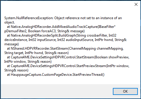

  7. Update:
    So i received the HDMI cable i ordered(i got two of them, just in case) and...still doesnt work. It worked for A 10 min. video but that was after i changed both cables and installed the new update for capture but now it keeps screwing up...again. i didnt change anything except for the cables themselves. i tried recording via component(a plan b of sorts), that worked for a little while but now that wont even work. recording via composite still works tho...
    im starting to think that it may be the pvr itself that is screwy but it doesnt help that every time i try to stop a recording, capture freezes and then stops the recording or stays frozen until i force close it. And every other time i started capture i kept getting that error message i mentioned before but this time i got a screen grap of it. i feel like im gonna have a mental breakdown or something, it feels like ive been trying to get this thing to work properly for, what feels like, eons.
    PS: i gotta know, would an el gato hd60 been this big of a pain in the butt?
    PPS: Ive tried running capture "as an administrator" as well and nothing.

  8. Have you tried capturing at the lowest bitrate setting?
    I don't know about the El Gato HD 60 but older Gamecapture HD has very high CPU usage.
  9. I just tried recording at the lowest bitrate(.20 Mbps) and it was fine, crap quality(which was to be expected) but nothing messed up. I also tried the highest setting, 14.00 Mbps, but that crashed capture 7 min. in to the recording. 10 mbps and 9 mbps (both in the "high" quality settings) didnt work and neither did 8 mbps(medium quality) but 5 mbps(.10 before the medium quality) did fine. all of those were with the HDMI, i dont know if recording via component would yield anything different.

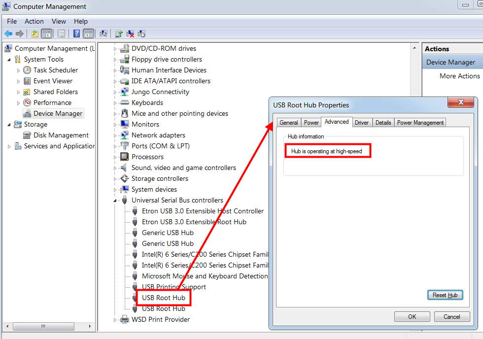

  10. It looks like your computer just can't handle over 5 Mb/s. Recording via component shouldn't be any different. Check your internal hard drive (Device Manager) and make sure it's using DMA. Check that the external USB drive is running USB 2.0 speed, not 1.2. Make sure the HD PVR is connected via USB 2.0 too.
  11. I checked the DMA, i had to turn it on. i think that both the external hard drive and the pvr are connected via usb 2.0, but im not sure how to check.
  12. After switching your internal drive to DMA can you capture to that drive at higher bitrates?
    To check USB speed: From Device Manager:
    Full speed = USB 1.2, High Speed = USB 2.0. Check all the USB controllers. Try different USB ports -- not one right next to the mouse or keyboard, for example.
    You can also use an disk speed program to check the speed of the external drive.
  13. I switched the DMA on and switched the usbs so that both the pvr and external hard drive are using usb 2.0 and when recording to the external drive i still get the problem BUT when recording to the internal hard drive, it works fine(at 11.00 mbps). recording to just a folder on my desktop isnt ideal(i do have enough space to record but it would be more ideal to record to the external hard drive) but ill take what i can get at this point... hopefully i wont run into anymore problems *knock on wood* *fingers crossed*
