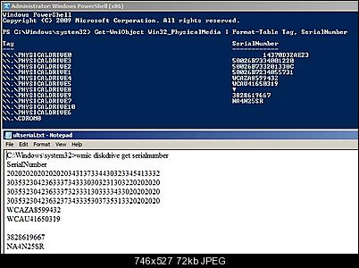

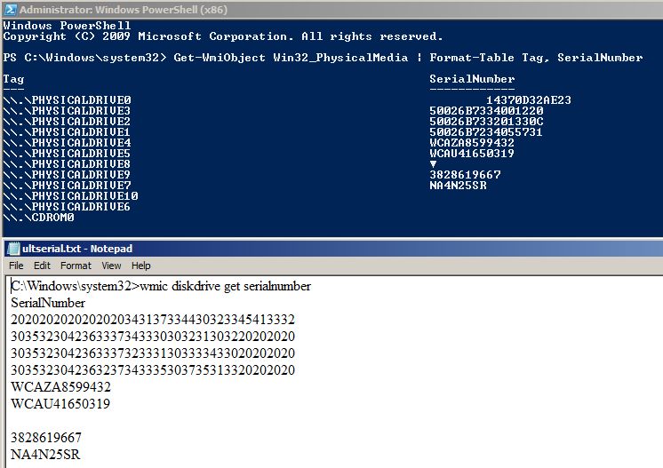

    The command line doesn't work on W7 Home Edition - but booting into W7 Ultimate, the command returns some odd numbers for the first four SSD drives (lower image).
    Whereas the PowerShell command on W7 HE returns the actual manufacturers serials (eyeballed by me) and agrees with the SIW program (upper image)
    I'm not familiar with PS scripts but expect it would be possible to match the two serials to the correct source/destination drives....

  10. The sequence of hex values "202020...." corresponds to the physical drive 0. 20 is a space, 30 is 0, 31 is 1 39 is 9, 41 is A, 42 is B, etc. Except every pair of values is reversed, a big endian vs little endian issue.
    20 20 20 20 20 20 20 20 34 31 37 33 44 30 32 33 45 41 33 32
    in order:                4  1  7  3  D  0  2  3  E  A  3  2
    pairs swapped            1  4  3  7  0  D  3  2  A  E  2  3

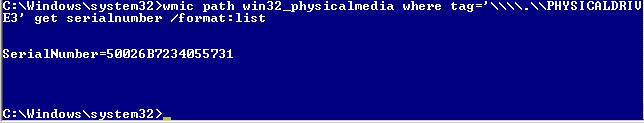

    There is a way to bypass the error I get on W7 HE, if you know the Disk number (e.g. Disk0 being system or C ) of the drive, you can use:
    wmic path win32_physicalmedia where tag='\\\\.\\PHYSICALDRIVE0' get serialnumber /format:list
    Note the six backslashes in front of the drive number.
    The image shows the serial for my Disk 3, which is correct.
    So a batch file would verify the source and destination of a cloning using the unchanging manufaturers serial#.

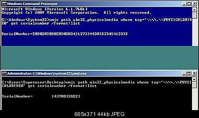

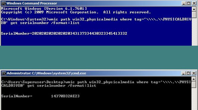

    Since I'm beating this to death, maybe someone can explain the why of this: run the command as a user and get the long little/big endian version or as an admin and get human readable version of the same serial number.
