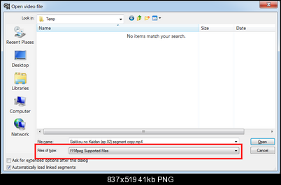

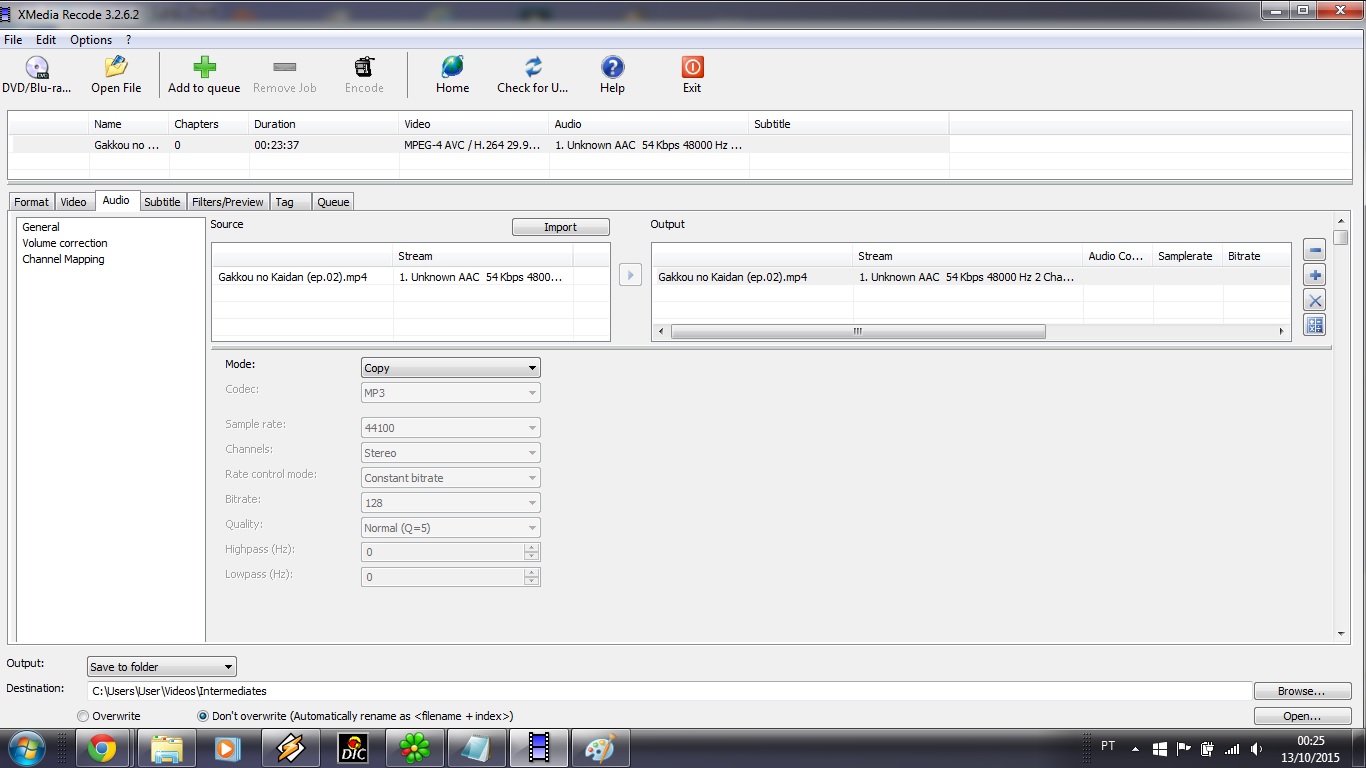

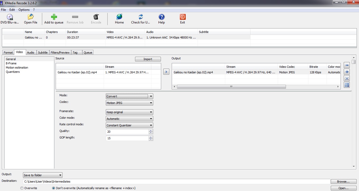

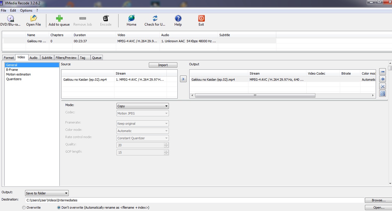

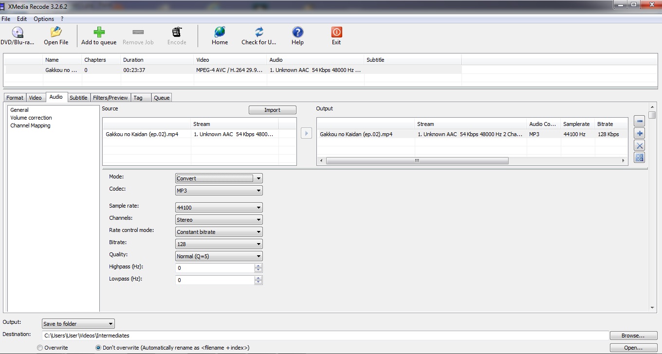

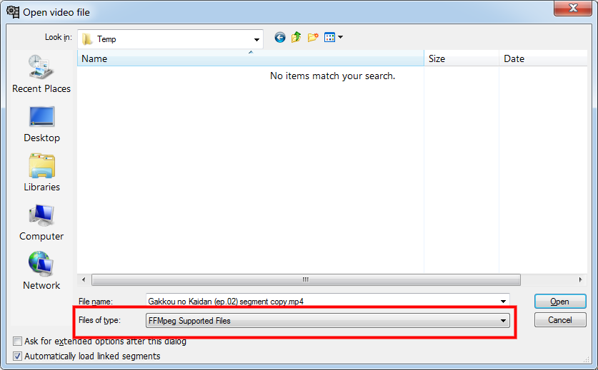

  11. Thank you all.
    I must say that xmediarecode is a great program for my purposes. The problem is that the resulting mjpeg video has lower quality than the original, what does not make sense for me. Yes, I keep the "Framerate" option as "Keep original" in the Video tab.
    Do you have any idea about why is it happening? Is there any option I should change in order to keep the quality?
  12. Member Cornucopia's Avatar
    So that we can be on the same page and not guess, you could post the MediaInfo text readouts of the sources and target clips. Only way to go beyond that is if you uploaded clip samples. And encoder logs.
  13. mjpeg isn't a lossless codec - you always lose quality.
    Set the quantizer to 2 as before in ffmpeg , and it should give the same quality loss as when you used ffmpeg (xmediarecode is a ffmpeg GUI)

    I got 2 examples to show you what's happening.
    I've used xmediarecode to get segments from the original files.
    1.1 and 2.1 are the original files (they were not attached, since they are big, and I think it's not useful to do that)
    1.2 and 2.2 (those ones named as "segment copy") were just unconverted segments of the original files.
    ( using these settings of xmediarecode:
    https://forum.videohelp.com/images/imgfiles/OvNcVaJ.jpg
    https://forum.videohelp.com/images/imgfiles/W7YvYE6.jpg )
    1.3 and 2.3 (those ones named as "segment converted to mjpeg") were basically the same segments converted to mjpeg files which should work as intermediate files for my editings.
    https://forum.videohelp.com/images/imgfiles/eBiFPYH.jpg
    https://forum.videohelp.com/images/imgfiles/TSSenUf.jpg )
    1.2, 1.3, 2.2 and 2.3 were attached to this post.
    As you can see, 1.3 and 2.3 are very different from 1.2 and 2.2, since 1.3 and 2.3 got lower quality than the original ones. That's strange for me. I'd like my mjpeg intermediates to be similar to the original ones.
    Since I'll still have to do that same process with over 30 or 40 files (with many different codecs, formats and containers) to do my editings and I don't have much time, I'd really like to know what's going wrong, what I got to do.
    Please help me. I don't have much experience, I must be overseeing some crucial settings of xmediarecode.

  16. in the mjpeg configuration , you have quality set to 20, not 2. I think that's supposed to be "quantizer" . If it is, lower quantizer values yield higher quality, higher filesizes . Pick a value that you can live with in terms of quality vs. filesize
  17. Set quality (not quantizer) to something around 90% (9.0?). Anything lower than 75% is easily perceived in JPEG/MJPEG (at least for me)
  18. Originally Posted by Clever Sleazoid View Post
    Virtualdub just can't work here, since it just generates black videos.
    Use the ffmpeg source plugin for VirtualDub. Force it in the Open Video File dialog with the Files Of Type pulldown.
  19. Thanks. I'll try to see what's going wrong with VirtualDub later, when I'll have finished my job.
    And thanks again, since I've set quality to 2, xmediarecode worked like a charm, just as I needed. Just one more question: can't xmediarecode convert segments with their respective external subtitles (in their respective places)? Or will I only be able to manually insert the subtitles for the intended part by myself?
