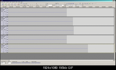

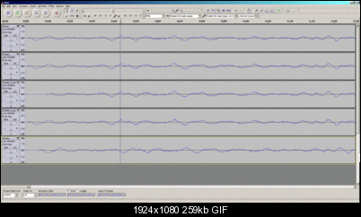

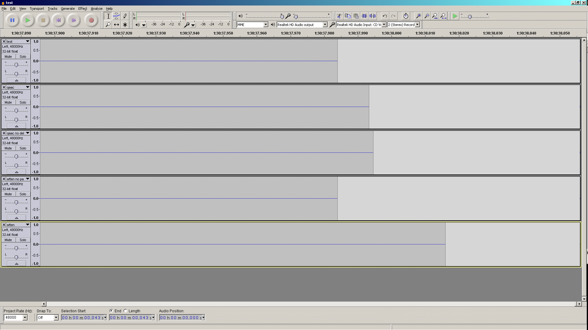

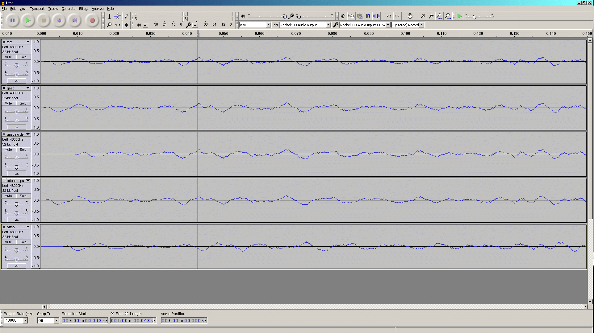

  4. Interesting. I guess that means the original audio was clipped at some stage, maybe even before it was converted to AC3 (and it looks like only in one channel).
    How are you importing the audio into Audacity? Is it already PCM or is it AC3 and you're converting it to a wave file first? I ask, because your screenshot shows it as being 16 bit PCM, which means peaks can't be above 0dB. If it's AC3 and you import it directly.... and it probably requires the ffmpeg files..... it should be imported as 32 bit float.
    Indeed, only the left channel has red lines.
    I directly dragged and dropped the AC3 file. I did it again with "Open..." menu, same result. I can change the sampling mode to "32 bit float" afterwards by clicking on the arrow on the left pannel, but I'm not sure if it has any effect at that point. I don't know why it's not imported that way right away. In the "Quality" settings it's set to "Default sampling format : 32-bit float".
    Another thing I noticed in Audacity : there seems to be a slight delay between the original AC3 audio and the reencoded AAC (QAAC), about 2100 samples between two identical peaks. I tried with QAAC's "no-delay" option but had the exact same result. Is it to be expected ?

  6. I played around a bit and below is what happens when I use QAAC's no delay option, but when I didn't use it, the QQC encode looked identical to the original. I assume the 'no delay" option has something to do with the very beginning of the audio being silence, but given I only use "no delay" when re-encoding "soundtrack" audio I don't really care.
    While I was playing around I discovered the AFTEN AC3 encoder was the odd-one out. When I converted to other formats using other encoders, foobar2000 reported the same number of samples as the original every time, except for AFTEN, when it didn't. The AFTEN AC3 encodes were a bit longer.
    After a bit of playing around I discovered adding "-pad 0" to the AFTEN command line fixed that. It appears to work in a similar way to QAAC's "no delay" option. I don't quite understand though, why the AFTEN encode without -pad 0 appears to have a different total number of samples to foobar2000. For most other formats, the padding info is saved with the audio and the player should know exactly how much is padding and to ignore it, but for AC3, maybe there's not a similar option.
    Anyway, the first waveform is the original (I split the stereo audio deleted the right channel after importing each time).
    Second is qaac.
    Third is QAAC with "no delay".
    Forth is AFTEN with -pad 0
    Fifth is AFTEN.
    They all line up except the last one (although it's only about 6ms out), and QAAC with "no delay" has about 9ms of silence at the beginning where there should be audio.

    I'm not quite sure what to make of this yet, but keeping in mind foobar2000 reports the same duration for each of these (same number of samples) except the last one, I'm thinking any encoder padding at the beginning is being ignored when the audio is imported (as it should be), but it's not if there's padding at the end.
