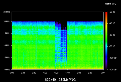

    Ok, so I define a good quality as more than 18khz in audio spectrum. Click image for larger version
    And I'm not afraid about HDCP, 'cause I have splitter which worked like I saw in other users of capture cards.
