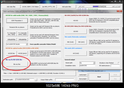

    I believe I did, this is what I clicked on after pushing start: (attached)Click image for larger version
