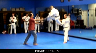

    Thank you both for your response. Very disappointed indeed. But I appreciate the humor, johnmeyer. Before I give up on this, I thought I'd upload a screenshot of the paused video to see if HOW blurry it was would make any difference. Granted, it is a motion shot, but parts of the background are stationary. We were hoping to use pieces of this video on a website and Facebook page. Thank you again for your input.Click image for larger version
  5. It would be more helpful to post an actual video sample.
    If your video is not HD, the screenshot suddenly became larger than SD ? So how was it scaled ? The method of scaling affects the sharpness or bluriness
    Also how was it processed in terms of deinterlacing - for example, if you blend deinterlace it will become more blurry
    You said it was on a tripod, but was there constant camera motion ? The reason I'm asking is there are 2 general categories of deconvolution filters, one is for out of focus, one is for directional motion blur. The latter can usually be improved on more than the former. (But don't get your hopes up - real life is nothing like CSI the TV show)

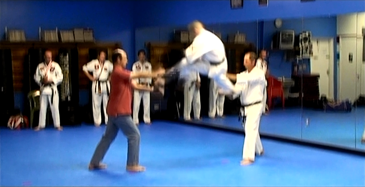

    There is something funky going on with the video, it's not (just) out of focus. The entire image has a vertical wobble to it. I have attached a de-interlaced and slowed down clip, which demonstrates the effect.
    Can't really imagine any way to truly fix this, but perhaps some improvements can be made. The audio, at least, is good so maybe a passable video could come out of it for web viewing.
    Would be interesting to know what actually caused the problem, so you won't run into it in the future. Maybe the camcorder has some kind of image stabilization feature that went crazy? The effect reminds me of how video shot on motorbikes etc. using rolling shutter cameras looks, but obviously there should be no shaking going on with a stationary tripod...

    I tried a quick fix using AviSynth, can't get rid of the jello effect but at least the image wouldn't be quite as twitchy. Maybe with audio a video like this would be better than nothing, up to you of course.
    It might be possible to reduce the waviness further, but it'd require some pretty involved work and double exposure look would still remain.
